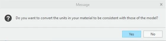

If I change to input the units in KSI, CREO automatically converts to this "lbm/(in sec^2)" the next time the material is selected.
Are you clicking "Yes" to the question below? If so just click "No" and your units won't be converted.
Otherwise where is it that the units are being converted?
