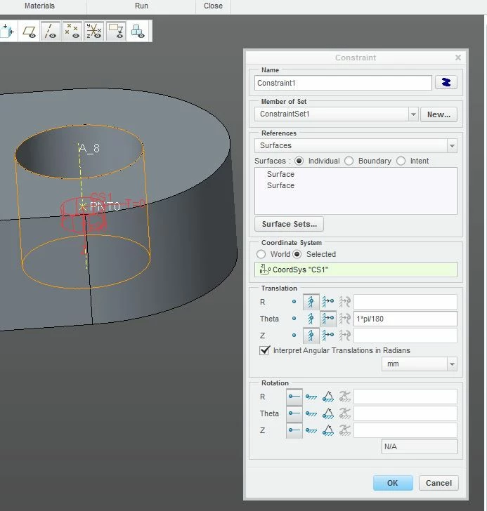

 i want to know stress of twisted part on 1dgree.
could you let me konw how set "prescribed rotation" in constraint

you have to set a cylindrical coordinate system and refer the translation to its theta.
Remember to flag the interpretation like radians.

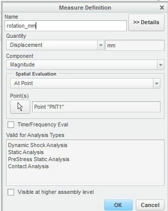

You can check out the result by making a displacement measure; it's being in mm, so it's measuring the arc of displacement.
You can't measure directly the angle; the measure "rotation" serves for beams or shels nodes that have also rotation degrees. The solid one doesen't have rotation degrees.

February 22, 2019
Cylindrical coordinate system - watch this limitation for twist situation.
Interpret Angular Translations in Radians  - Beware that this cannot be used for Large Displacement.
