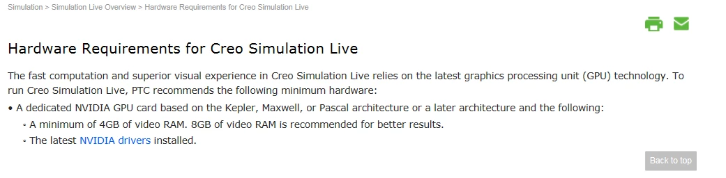

I looked up the requirements of Simulation Live and found that it only supports up to Pascal architecture(GeForce GTX),but RTX is Ampere architecture.
I wonder if anyone has the same issue but has solved the problem.
