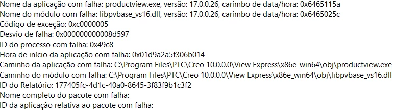

Jun 19, 2023 1:25 PM UTC
I do get an error on event viewer, and theres a resolution on Article - CS302448, but it's for older versions, i've tried it anyways, but with no success.
I've tried in 4 different laptops, same thing on all of them.Screenshot 2023-06-19 142519.png
Jun 19, 2023 1:29 PM UTC
how did you set PVIEW_LANG=en ?
