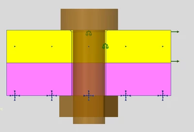

I Anchor the pink part , I apply a tangentiel force (500 N) on the yellow part .

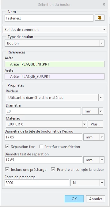

This is  bolt définition with a preload of 8000 N

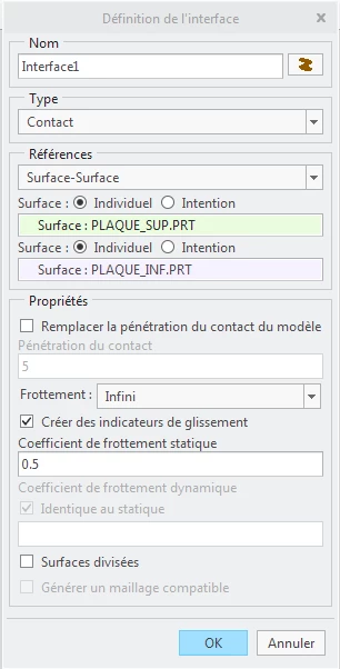

I define a interface with a infinite friction and a friction indicator at 0.5

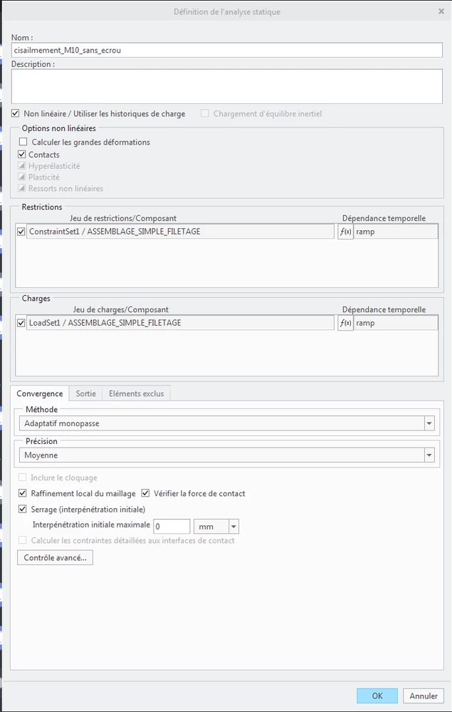

the analyse settings

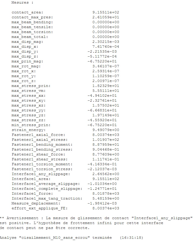

and here are all the results
Result analyse : to do simple , the preload is 8000 and the indicator is 0,5 , in theory the max tang force will be 4000 N before slipping.
the fastener shear force is low but about 10N , weird ... and the slippage is present ,  it could not be

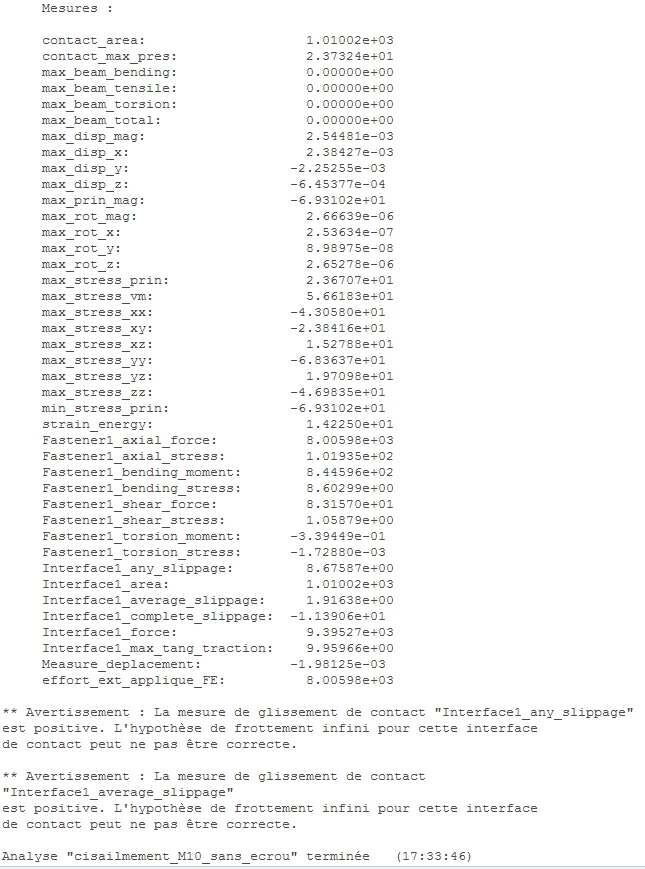

I've tryed with a 5000N tangential force
here are the results
In this case the yellow part must slip and I can notice than the Interface1_complete slippage is not positif ...weird again ...
the shear force must be about 5000 - 4000 = 1000 N , is it not ...weird ?

You can select the contact surface (pink-yellow) and also create a force measurement in the direction of the applied force. This should be be easier to interpret.
You may spot local sliding in the interface but this not means that it will slide. Check the contact colors regarding sliding in the result.
What I cannot identify in your simulation is if you are making use of the "real" preload - considering the flange stiffness. Simulate 5.0 has this option. It modifies the preload until get the "real"  8000N. But I think it is selected.
