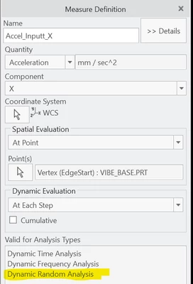

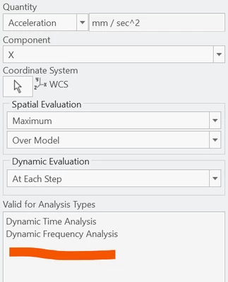

Hi @JXBWk ,
Do your measures show that they are valid for dynamic random? (see images below)

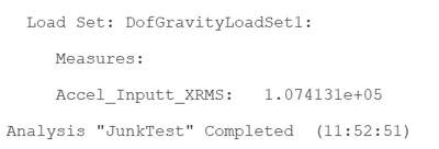

Jan 31, 2022 4:55 PM UTC
... and now I see even clearer. RMS levels are a single number so they will not show up as a PSD plot and so will not be available to plot.
If you make a RMS measure it will only show up as a single value in the run summary as shown below. To get a PSD style plot you need the "at each step" option.
