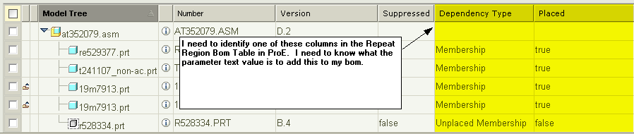

I am trying to find a way to filter out unplaced members from my repeat region table. I need to figure out how the sys parameter is written for part placement. In PDMLink when assembly structure is shown there are two columns that identify is part is placed in the assembly. Dependency Type: Membership or Unplaced Membership Placed: true or false I need to add a column to a Repeat Region Table to identify these parameters. The goal is to be able to filter by text all unplaced parts from the table. asm.mbr.name = Part Name prt.qty = Quantity asm.mbr.PTC_WM_VERSION = Part Version Iteration What is the parameter for the "placed" identifier?
