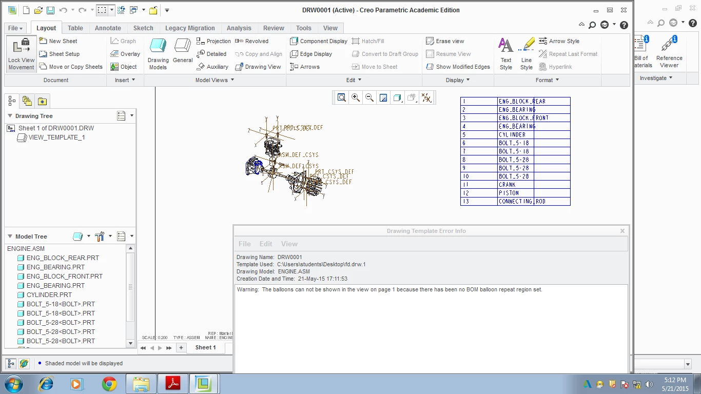

Actually I have created drawing template for my assembly to get BOM and balloons. while creating the template view i have added balloons also. but when I use that template for my assembly one warning is coming. Please find the below attachment. (my view is in the master rep).
note: manually if i try to give balloons its coming.
Thanks in advance.

Elango,
Check the representation of view, it needs to be of master rep of assembly.

1. Open template
2. Applications > Template
3. Select table > properties > check bom balloons properties
4. Save template within template mode

when i do with only one view ,i am getting the balloons. If i create the template wih few views (along with comb0001 if i do front, projection). that time only error comes

TABLE- BOM BALLOONS-  SET REGION- CLICK ON THE AUTOMATIC BOM TABLE IN THE DRAWING.
TABLE- BOM BALLOONS-  CREATE BALLOONS- CLICK ON THE VIEW THAT NEEDS TO HAVE THE BALLOON.
