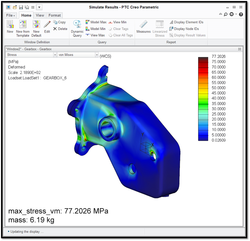

Here you can see the current mass of the part is 6.19 kilograms.

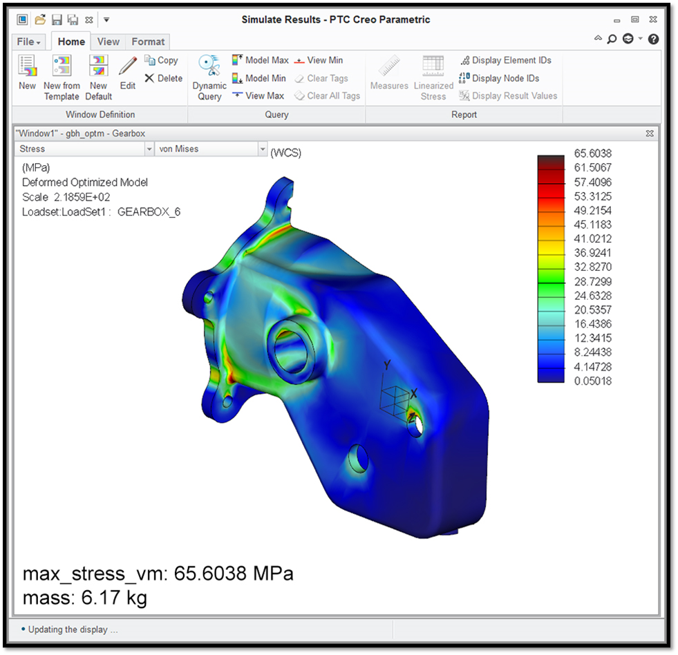

When the run is complete, click Review Results to open the Results Window Definition dialogue box. Keep all the defaults and click OK and Show. Note the mass has been reduced. You can explore other measures to review any other changes the optimization may have caused to make sure that it did not have any unintended changes. When the review is complete you can close the result window using the File navigation. You do not need to save the results. In the PTC Creo Simulate window close all dialogue boxes and erase the model from memory. Using the File menu navigate to Manage Session and select Erase Current. Select Yes from the Erase Confirm dialogue box to finish the process.
In this example, the optimization reduced the total mass to 6.17 kilograms.
