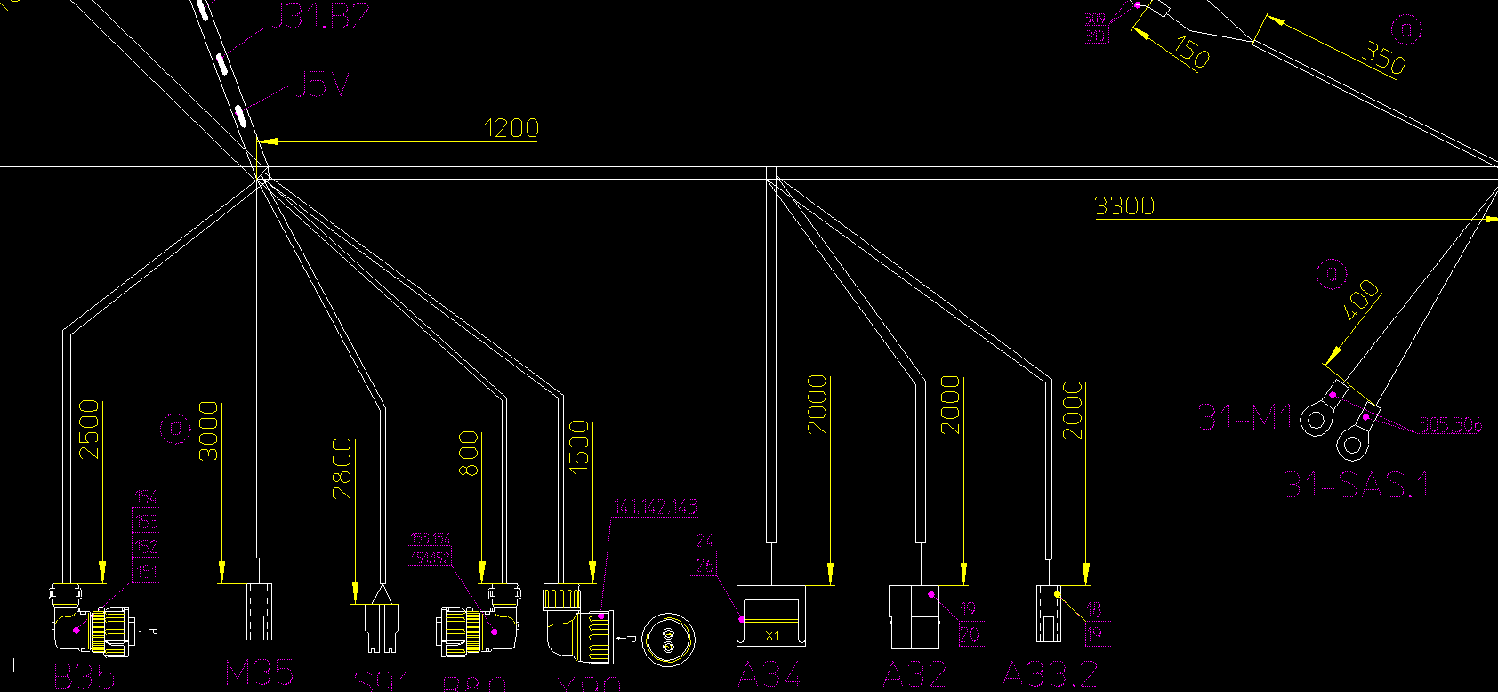

in our company we bought cabling module for Creo/ProE 5 and now I have a problem with style of dimensioning cable lenghts. Before ProE we used old ME10 to draw cables and ME10 have a good function for dimensioning called 'Linear Datum Short'. You can see on added picture how I used this function. Now I have a question: How could be done this with Creo/ProE in drawing mode?
Thanks in advance for help and suggestions,
Simon
Best answer by TomD.inPDX
You are in luck...
Video Link : 5122
July 10, 2014
You are in luck...
Video Link : 5122
