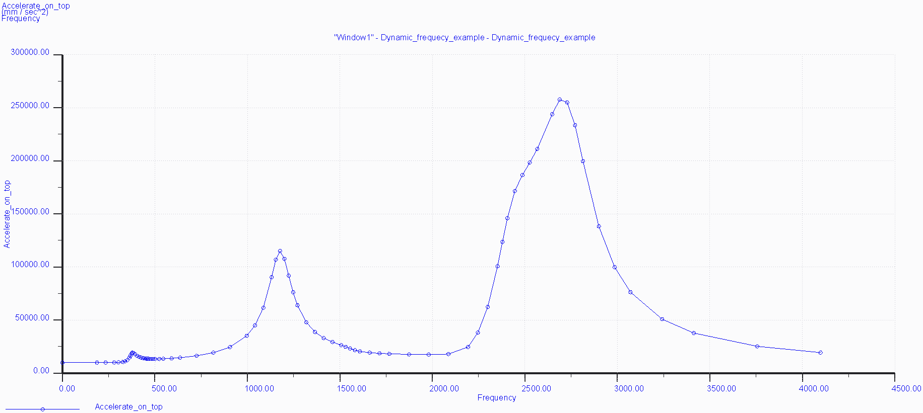

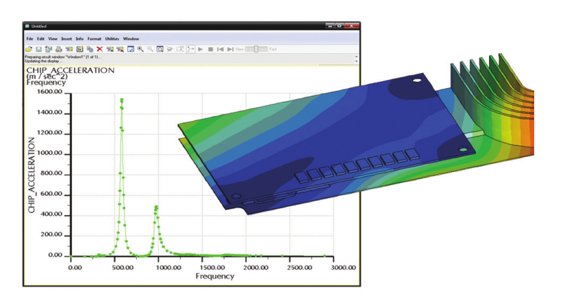

Hello , I need an example to simulate a Dinamic Frecuancy response as on CReo Simulate ADvanced Simulation Data sheet is written and  possible to be done , I tryed to obtain a(t) versus F( f Hz) as in PIC on data sheet is but it was not posible
any help??? , someone can provide me any simple example??? for this to be postprocessed?
February 2, 2016
Hello Oscar
It's not that hard, but you might require some training in dynamics.
I've got an example of such a graph here
You can reproduce that by running the analysis "Dynamic_frequency_example" from the mirror.asm model that I enclose.
When the analysis is completed you can make a graph of the only measure that is in the model.
Succes!
Erik
