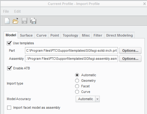

I have a question about distributed batch.  I need to import several thousand parts that are SolidWorks parts and assemblies.  I want to use the distributed batch to convert the files to Creo Parametric.  I have no issue getting the batch to run and convert the files but I need to have the files read our templates. This way the files will be compatible with our draiwng formats and other function.  I see that there is a line within the batch file for configuration files and point to the config.pro that has the template file options set but this does not correct the issue.
Does anyone have a solution? Can I use distributed batch and have it work like a manual import?  By the way, manually importing files works as I would expect.  Thank you for the help!
Best answer by Mahesh_Sharma
Ronald,
You can create a import profile and set config option intf_in_profile_default pointing to profile. When working in Distributed batch specify the config file under configuration options.

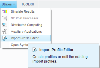

Thank you for your help on this issue.  This was the correct answer to my issue.  For those like me who do not know what a profile is or how to create it here is some more information.
Start Creo Parametric (I am on 3.0 M130)  but don't open any objects
Expand the Utilities and Pick the Import Profile Editor
It seems that this does read my config.pro because I have the correct template files for Part and assembly but (and a big but) the Use Templates is not checked by default.  All I had to do was check the option and save the file.
Now I can point the config.pro option to this saved file and all is working as expected.  Thanks PTC for the help and solution!
