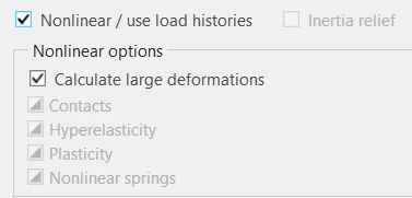

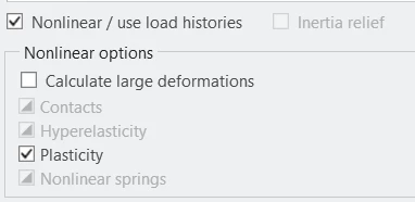

Does plastic deformation without large deformation exist in real physical situations?
In structural simulation, as my understanding that plastic deformation will lead to large deformation. In Cero Simulate, it is allowed to perform plastic deformation with large deformation deselected.
What are the differences between the following structural analysis conditions?
1. Only large deformation is calculated, plastic deformation is not calculated.
2. Only plastic deformation is calculated, large deformation is not calculated.
What is their actual physical significance? Are there any practical cases?
