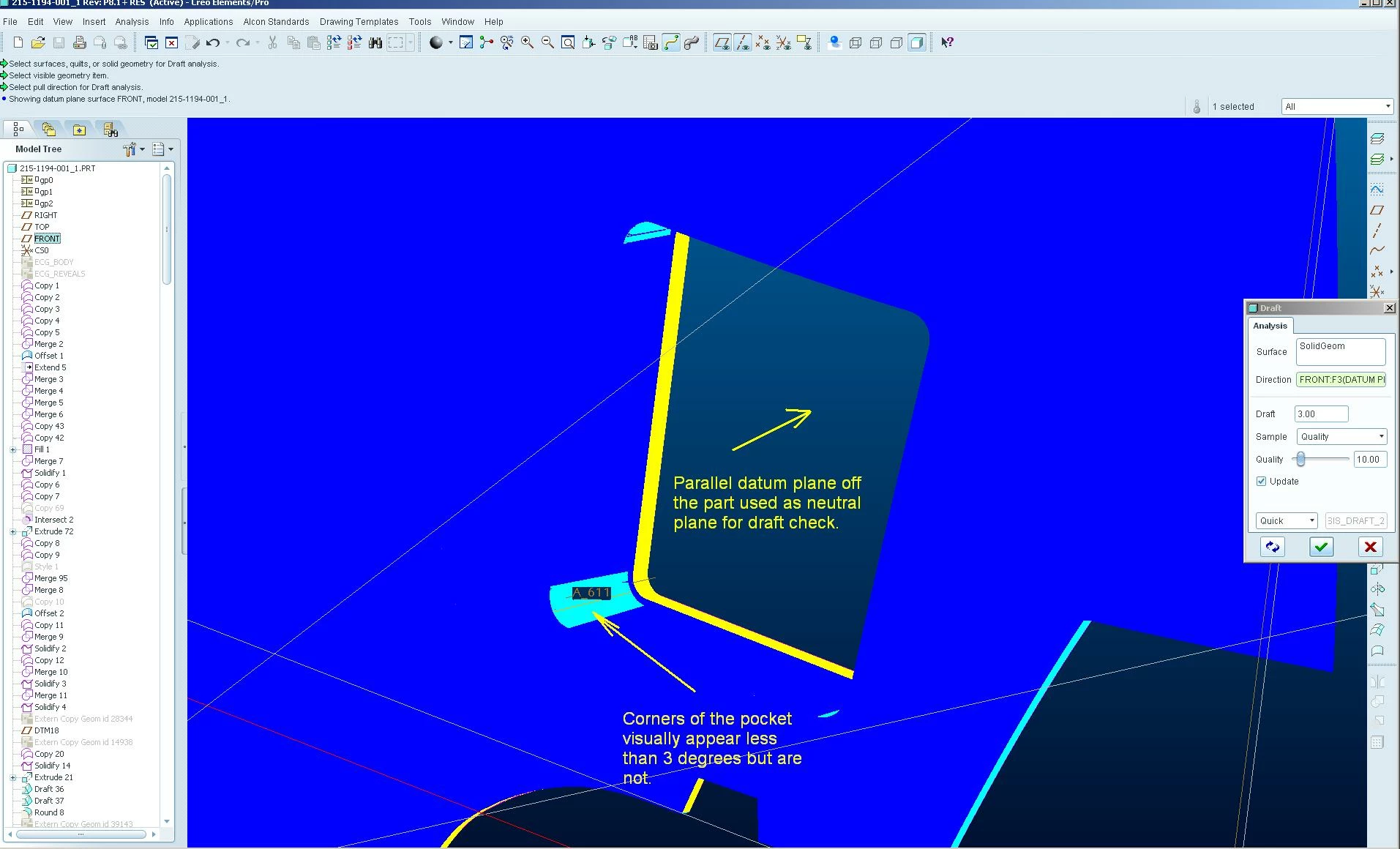

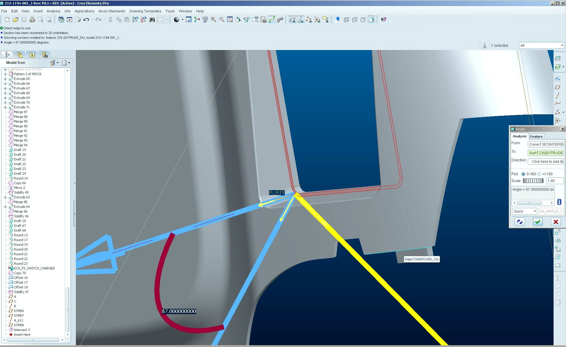

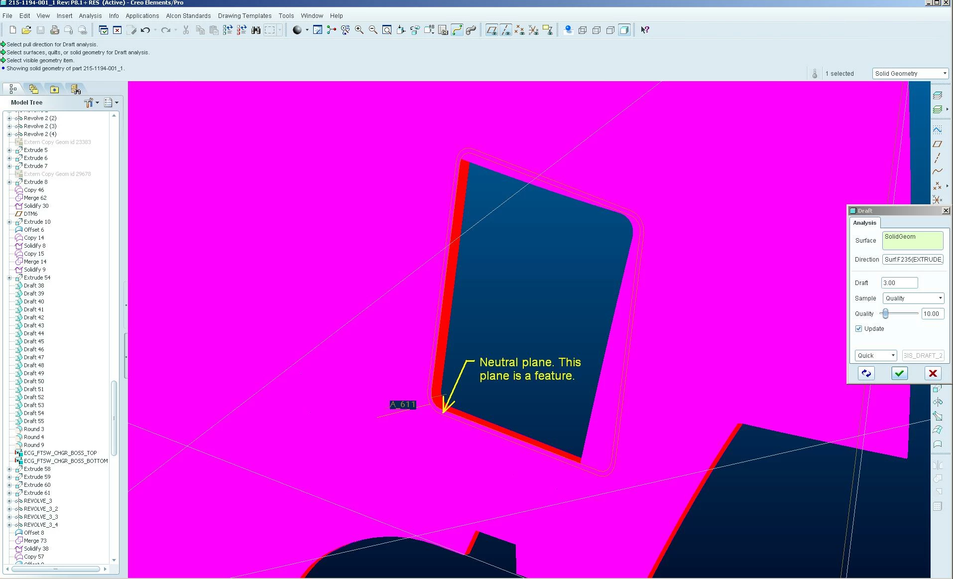

The attached pics demonstrate the issue I have with the new toolset.
I measure the angle of my draft explicitly and I get 87 degrees as expected. Image: "actual surface measurement"
I then measure using the Draft Check tool using the planar feature as the neutral plane and I get the report I would expect. Image: "using the part as neutral"
I then run the same Draft Check using a parallel plane offset from the part as the neutral plane and I get a different image report. Image: "parallel plane as neutral"
My neutral planes in each draft checkARE parallel...there should be no difference with the reporting of the draft visually, but there is. This is a huge issue that somehow has been overlooked.

Yes, that is the behavior I am experiencing.Selecting a planar feature of the solid geometry as the "pull direction"gives a different visual result than selecting a datum plane as the "pull direction". If you look again at the images I attached to this thread you will see these differing results.
A side note: By reversing the direction arrow once the analysis has completed, the visual anomaly reverses sides. If I had to suggest where I think you should look, it would be within the old "one direction - two direction" draft check selection from older revs and how that was revised to our current toolset. It almost appears as though there is some resultant conflict with the draft check results in WF5 code. In other words, the draft check seems confused as to what side to assign the colors at the explicit value input by the user.

A correct way to state the issue is: By measuring draftfrom a planar feature on the partas opposed to usinga parallel datum plane gives different results.
The issue of direction I pointed out was merely an observation. The differing results between usingthe planar feature on the part and a parallel datum plane happens regardless of direction. If it's still confusing we can speak offline.
