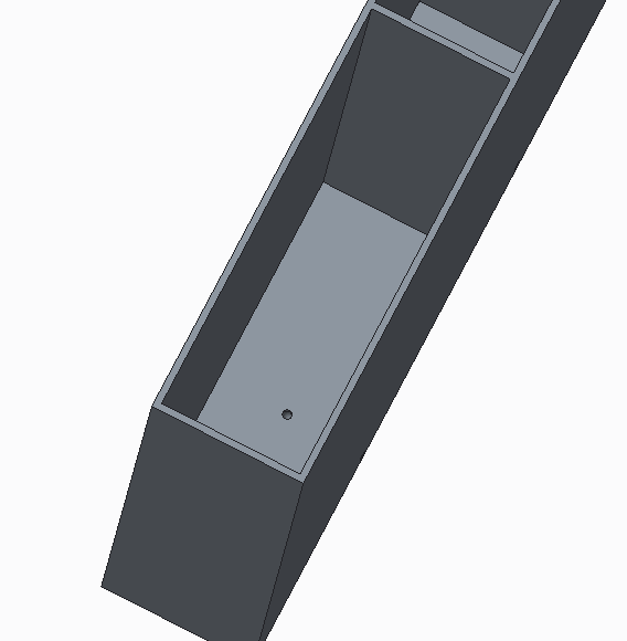

I'm making a series of tanks that share walls, with "built-in drainage" since it'll be 3D-printed (see attached file). What I'm trying to add is a slope from the edge of the drain at the bottom of each tank to the edge of all 4 sides of each tank. I want the "rise" of this slope to be 5mm, though this doesn't have to be exact, or I can calculate an angle, etc.
I have absolutely no clue where to start. What function do I use? My "go-to" is Round or Chamfer, but those don't give me control over what the slope is, since this will be rather gentle.
Thank you in advance!!!

* I should add that my files are created in the full version of Creo, not the student version so you'll be able to open it. Also, to make things easier, I'm putting a screenshot as well.
I think that what I'm trying to do can be best described as a shower drain at the center of a shower stall.

I added Revolved surface and Solidify feature in Creo Parametric 3.0 M010.
Martin Hanak

I am sorry I do not have enough time to create detailed tutorial for you. I can provide you a couple of tips...
If you want to know how specific feature is built, select it on Model Tree, press right mouse button and use Edit Definition command. Then examine feature section and feature settings.
Revolve feature:
  • it is created as SURFACE feature - Surface button is pressed in feature UI
  • section is related to the hole you made in tank bottom
  • diameter dimension value must ensure that the surface goes beyond the outline of tank bottom (reorient the model to see it from TOP)
Solidify feature:
  • uses Revolved surface as reference
  • is adding material under Revolved surface
Martin Hanak
