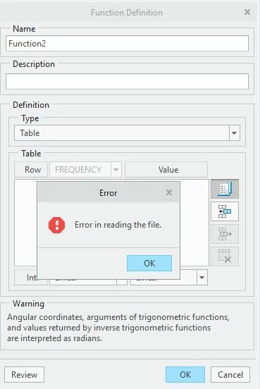

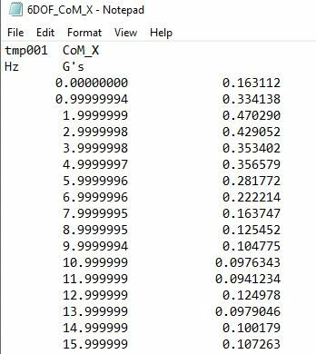

I have a question regarding importing test data as a driving function for Dynamic Frequency Analysis  (DFA) uding ascii format. I get the following error when I try to import the data. I can export the data in ascii format using diff delimitors (tab, space, comma, colon etc) but nothing seems to work.
Any suggestions regarding Creo capabilities (I am using Creo 4) or if I need to change data format somehow ?

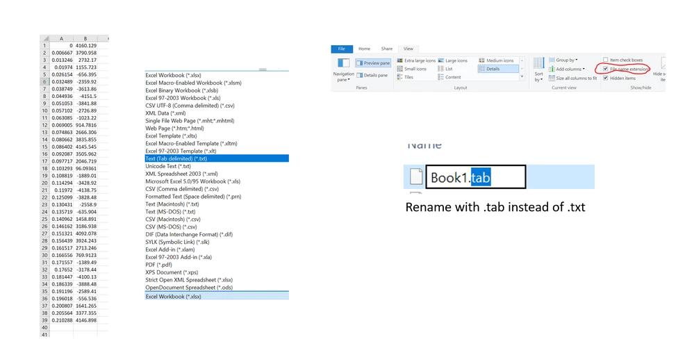

Create Tab FileCreate Tab File
I am also learning with this but here are my observations.
