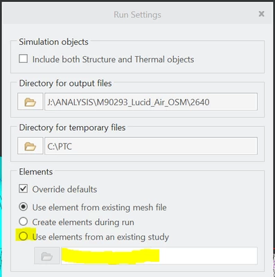

Two issues here, hope someone can help:
When I Run Dynamic Frequency Analysis (DFA),

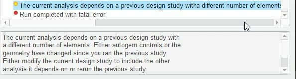

  • there is an option to use Modes from previous design study. In this case, Creo uses a previously ran Modal and starts with DFA load set. Pre-req is that previously ran modal should be stress output for this option to be used. The issue I am having with this option (most times) is that during meshing, I get an meshing error due to different number of elements even though I don't change anything between running modal and FRA. Also, I have tried changing run setting to use elements from existing study but I get same error. There is an article CS117018 from 5 years ago that I can see in the knowledge base and it says its been resolved. Anyone knows a resolution to this issue ?

Issue1: Still sometimes without changing the model, during a run it can decide to re-mesh.  This is due to an issue with the data that the mesher worked around but the mesh was "off" a little.  Try running a first modal analysis, then a run a second with "use elements from existing mesh", and selecting the first modal analysis to get the mesh from.Use elements from existing meshUse elements from existing mesh

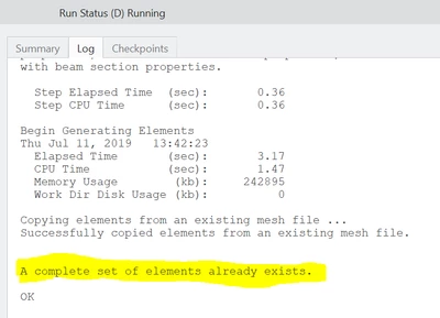

Then look at the status output for this...elements successfully copiedelements successfully copied
If that message does not appear, then you need to work on the geometry to fix the problems.  Use the same methods that are used to get a successful mesh on complex models, to correct this issue.  (start with simulation diagnostics).
Once you have this working you will no longer have it re-run the modal analysis.

Now if you do check "use modes from previous design study" you must first have run the modal analysis (with stress output)  Your model cannot have changed in any way from the way it was when you ran the modal analysis.  Furthermore if the "A complete set of elements already exist" message is not obtained you will get errors. (I am being obscure because I do not have this exact information at my fingertips).

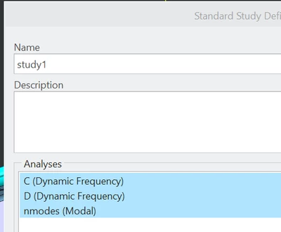

If you want to change your model and rerun dynamic, then you must have Creo run a new modal analysis as part of the study.  If you have several dynamics that you run on the same model, make a standard design study.  Creo is smart enough to realize that the nmodes needs to run first.  For my example the directory will be named "study1" and it will have subfolders "nmodes", "C", and "D".  (be sure to highlight the analysis to be run by the study)
Standard Design StudyStandard Design Study
Thus if you run "study1" and "study2" they will each have their own unique "nmodes" sub-study.  Also if you use descriptive naming instead of "study1" like "ribs_1mm_thicker" you can track the results without changing the name of the nmodes and the dynamic studies.
