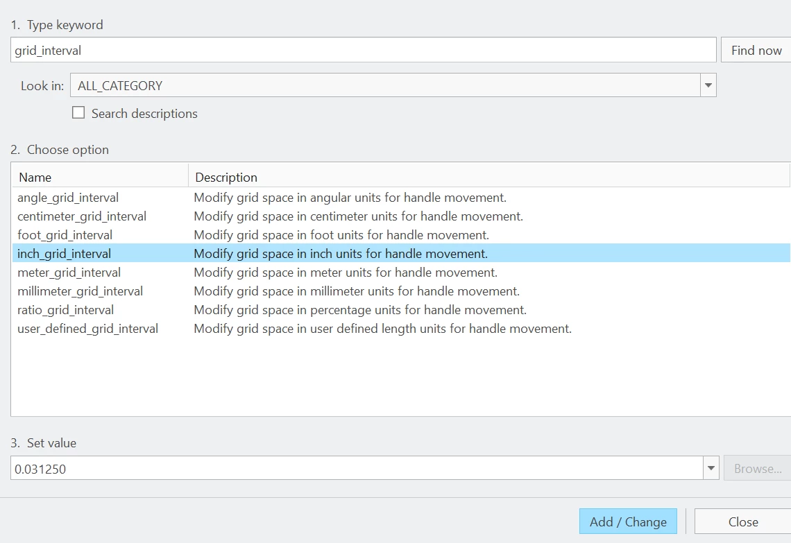

It seems like the Wildfire clipping function has been moved to the section function in Creo as dynamic sectioning.  I find the default increment of section dragging (.031 inch currently) to be too rough for the model that I am working with.  Is there a way to change the increment setting of the dynamic section dragging to be finer, or even better, to have a truly dynamic drag of the section?

Has anyone found a way to make to control the section dragging?  It sure would be nice to have it be a little smoother.  Currently using CP3 M100.  Thanks.

I am having the same problem when I use flexible modeling and I offset a face. I would also like to drag the face at a .005in increment instead of a .031in. Anyone find a solution?

It can be set with a config file option.
May 31, 2018
thank you. that did work.
