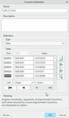

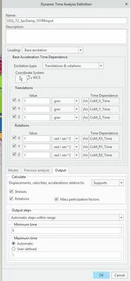

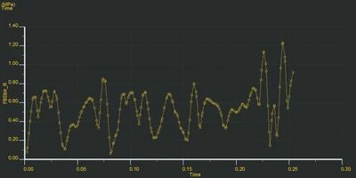

I have a question on Dynamic Time Analysis (DTA). I am inputting time history data for DTA that varies with time for about 25 min or so. The output I get does not align with the input, I only see 0.25 seconds of data.
I am attaching the snapshots to highlight my point above. Any feedback as to if such an analysis is possible in Creo or a change in output settings is needed somewhere, please let me know.
Appreciate all the help I have been getting so far. This community has been extremely helpful for someone trying to find things beyond typical online documentation.

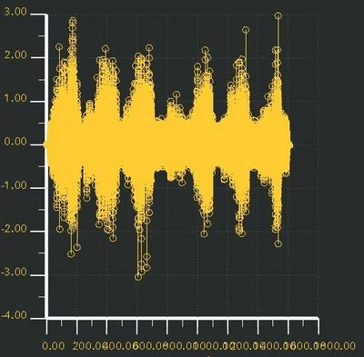

Analysis setupAnalysis setupTime history data inputTime history data inputInput Data as reviewedInput Data as reviewedOutput measureOutput measure

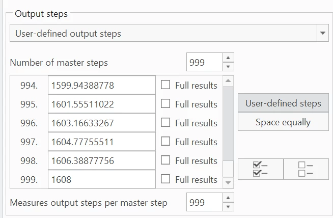

WOW!!! that is a HUGE dynamic time simulation.  You just might be overloading some data types for this.  Try user defined output steps set to the maximums like this image.  This will give you somewhat the same resolution on the output as you are putting into the inputs.  (around 500Hz sample rate is what I see)
change to user defined steps (2 default), then set the last step to 1608 seconds then change to 999 steps and hit "space equally"   Turn off all full results check marks for now.  Then change outputs per master step to 999.
You just may have to approach this differently. I suggest that dynamic random might be more appropriate.   The time domain data is pre-processed with a power spectral analysis before entering into the Creo PSD inputs.  Another possibility is to choose just the more aggressive portions of the time data, say the worst 10 seconds or something like that.  I am observing that the data appears to be generated by simulation and does not have a constant time step like most real world acquisitions.  A PSD algorithm that accepts arbitrary sample rates might be a difficulty.  On the other hand there are likely some methods to resample your input signal to a constant sample rate.

Maximum Output StepsMaximum Output Steps
