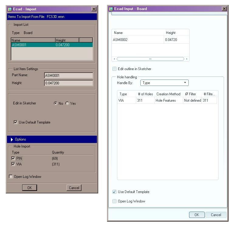

i recently had to import a revised ecad (.emn) file from allegro into proe, and i noticed that the resulting model was missing several holes when compared to an old revision of the board i still had in my directory. i then tried importing the new .emn file using both wf5.0 and wf3.0, and it looks like the wf5.0 ecad import window has changed. while most of the changes are cosmetic, the one im concerned about is that the wf5.0 import isnt recognizing the 69 pin holes that should be included in the model (see attached). what happened? is there a config option i have to change, or something im missing from the import window?
any help would be appreciated...

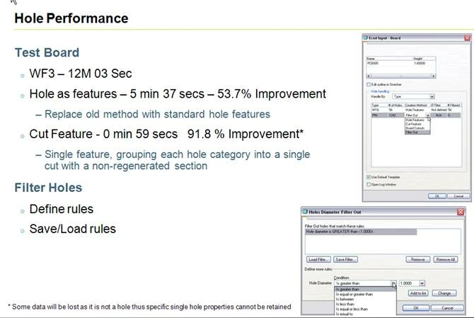

In Wildfire 4.0 we improved hole import performance hence the new UI. This allows you to filter holes based on type and size
If pin holes are not importing then set config option ECAD_PIN_HOLE_IMPORT to yes (the default is no)

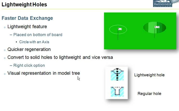

As a side note In Wildfire 5.0 we then enabled the ability to import holes as lightweight holes to further improve performance.

What do you mean by a “lightweight hole”? Are you referring to an EXTRUDED HOLE as a cut? Or are you referring to a REVOLVED SECTION?
