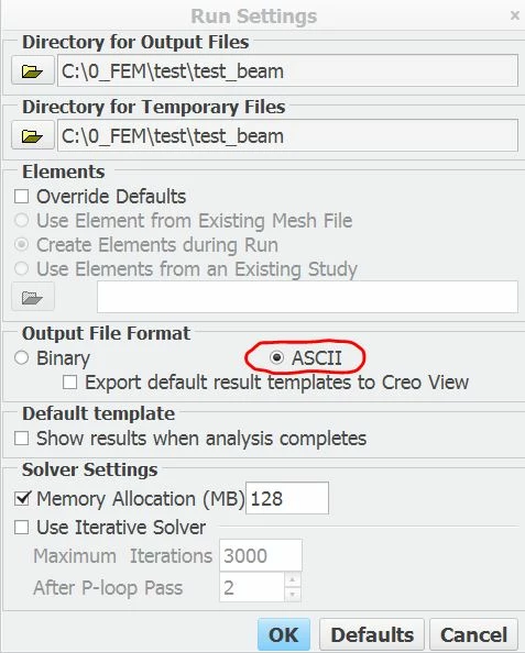

I am running a modal analysis of some componentes on PTC CREO Simulate. But the results produced by the simulation are only the natural frequencies (eigenvalues) and a graphic representation of the natural modes.
However I need a matrix with the eigenvectors of the problem. I am sure that there is a routine inside the Simulate that produces this information (otherwise, how could the program display a graphic representation of the modes?). Do anyone know if it's possible to extract the numerical matrix from the simulation analysis?
Thank you!

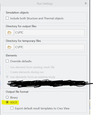

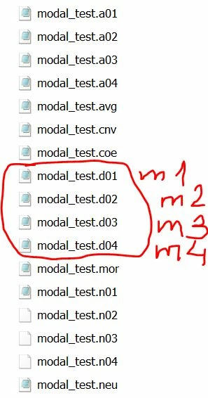

yes, of course
