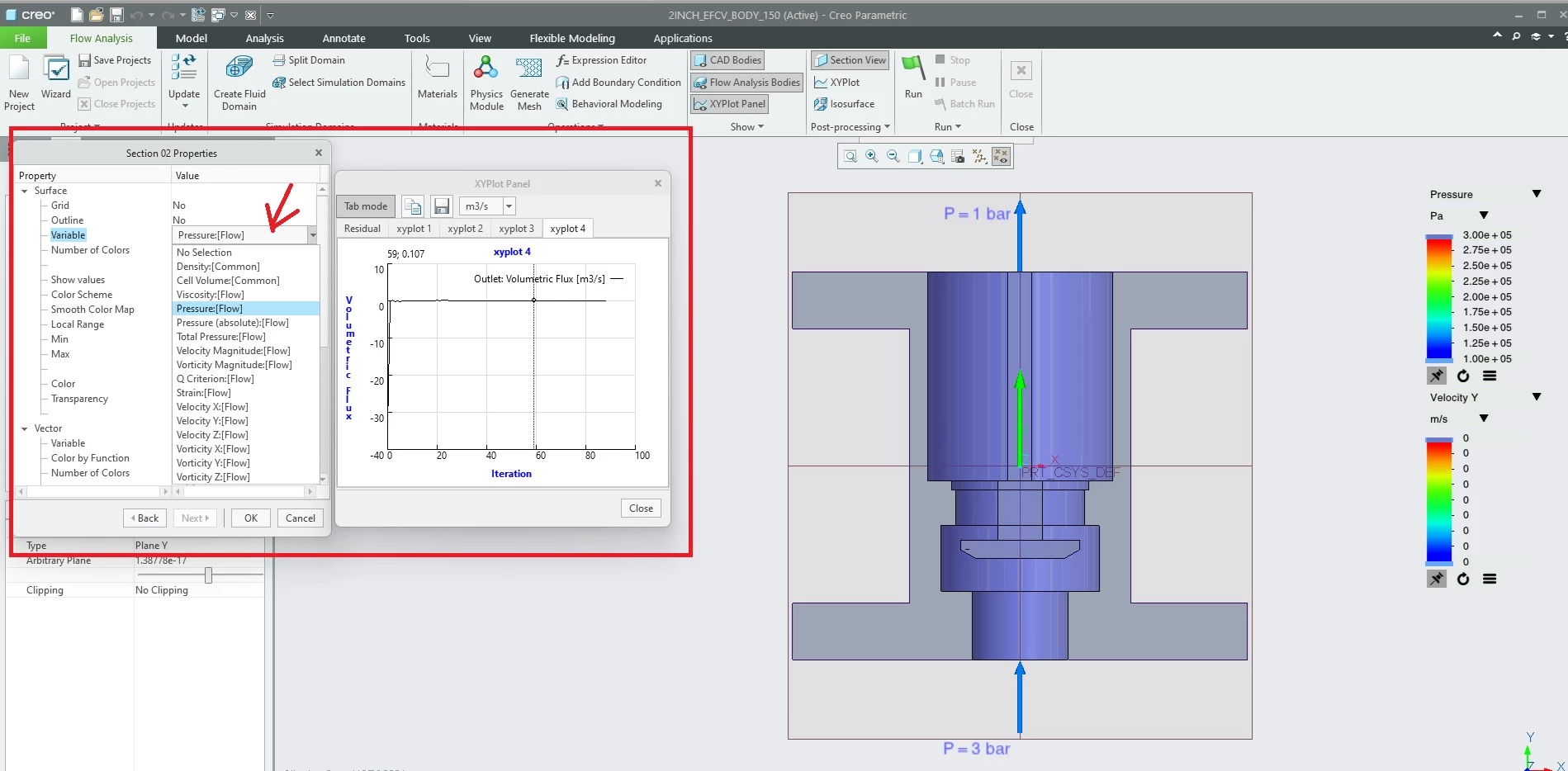

Enable Volumetric flow rate & volumetric flux in section window of postprocessing Creo Flow Analysis
Enable Volumetric flow rate & volumetric flux in section window of post processing Creo Flow Analysis. Can anyone suggest any workaround?
when will PTC introduce these variables in Creo Flow Analysis ?
Is there any development / work going on related to this subject?

Volumetric Flow Rate is fundamentally an integrated quantity across a surface and is not usable as a Surface Variable contour. Instead, it can be output as a value on an XY-Plot for any selected Boundaries or Interfaces. The steps are detailed here in the Post-Processing section of the Creo Flow Analysis manual:
https://support.ptc.com/help/creo/creo_pma/r9.0/usascii/index.html#page/simulate/cfd/PostProcessing.html#
You can find a list of the built-in outputs for Creo Flow Analysis in the online help here:
https://support.ptc.com/help/creo/creo_pma/r9.0/usascii/index.html#page/simulate/cfd/OutputVariables.html#
