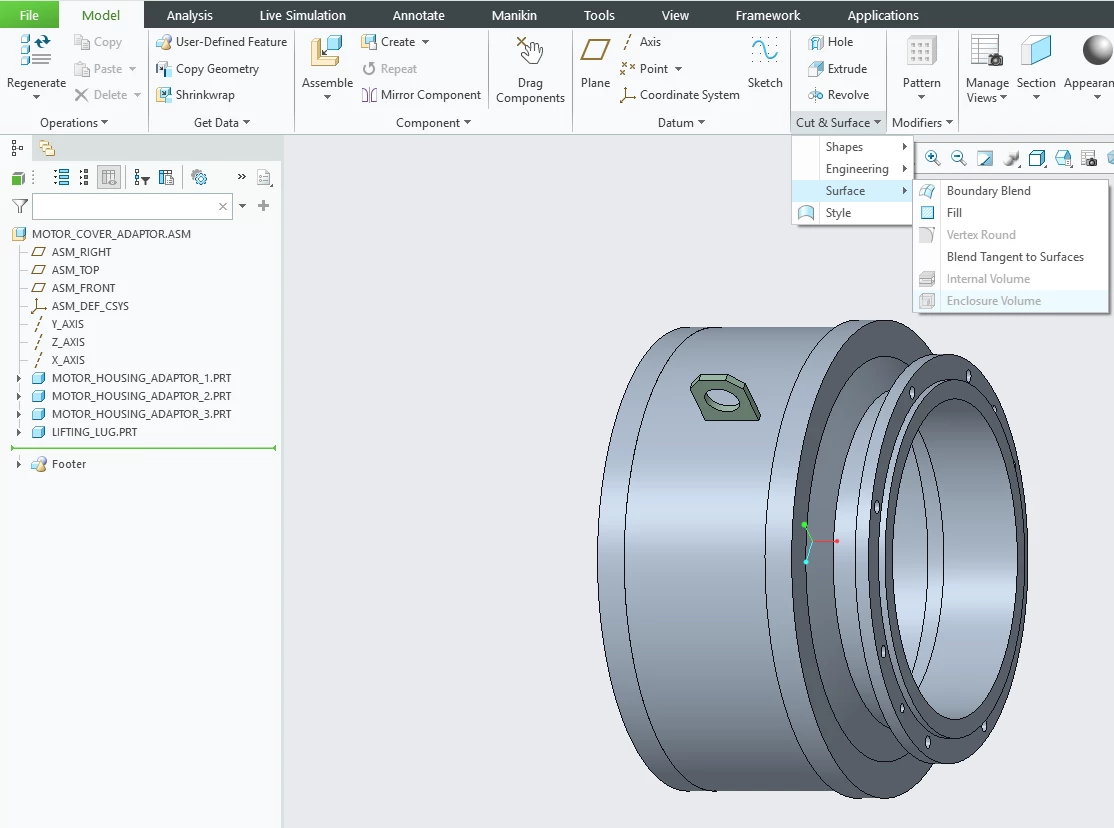

Enclosure surface option not highlighted
I am not able to find the enclosure volume. option not highlighted.
MikeBennett
Jun 16, 2025 12:00 PM UTC
Hello @Sagar_Thesiya
What release of Creo Parametric are you using in your image?
What licenses do you have available in this session?
According to CS326491, prior to Creo Parametric 11.0, this tool required the Simulation Live Advanced license option.  Starting in Creo 11.0, the tool is included in a basic license.
