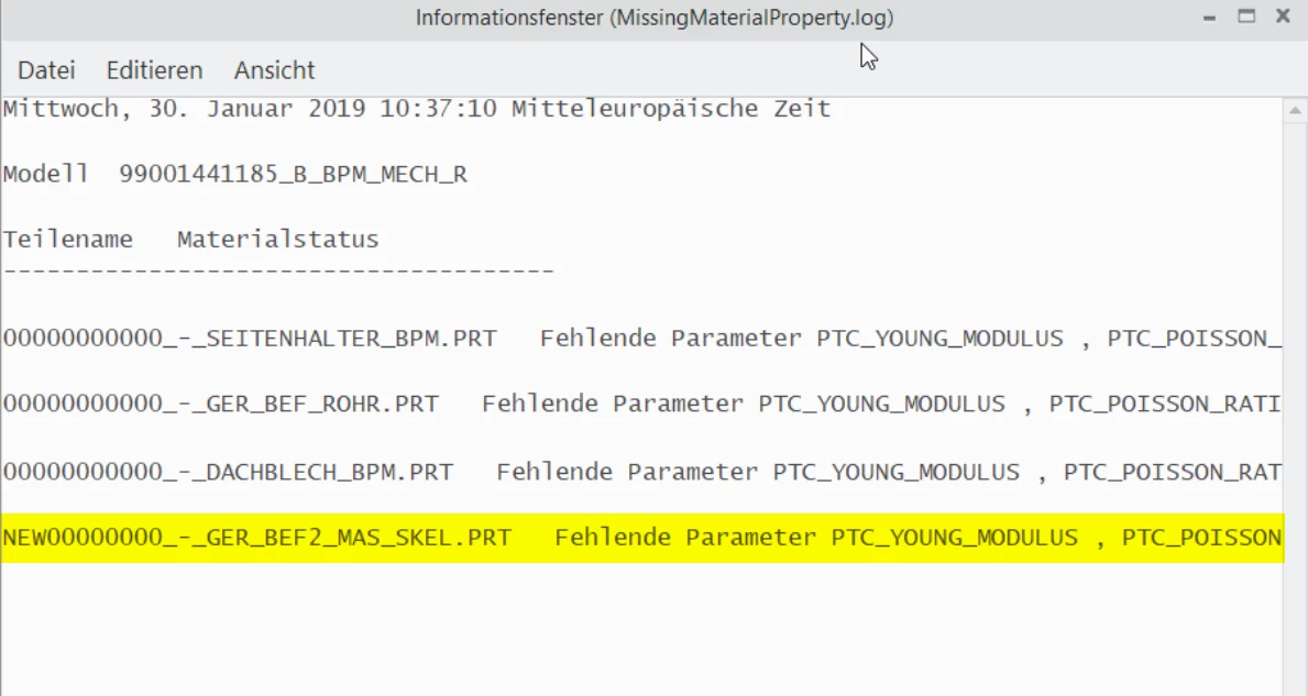

is it posssible to exclude a skeleton model from simulation?
A skeleton model has no material definition...
Thanks!

Yes, just make a simplified rep. with the skeleton excluded and use the simplified rep for the simulation.

Thanks for your reply,
yes, this is a possible way to do that. We have already had this idea. But what we need, is a config.pro -option (for example)....
