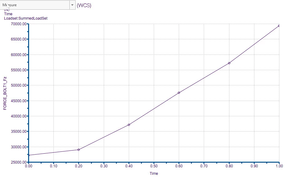

Currently I am facing following problem. I have done a Contact Analysis using 2 time step and I also wrote.
In the post processing I created a graph using a measure (force) vs. time. Somehow I cannot export the graph. Also I cannot plot two measures (e.g. bolt force vs. input force) that shows their correlation over each time step.
Somehow Creo creates several output-files and also folder of each time step but I am not able to find how to use this file and to extract the information I am interested in.
Below you find a screenshot of the graph I would like to export into a CSV or other format.
Within the post processing tool (Simulate Result) I was not able to export a CSV file. It was only possible to create a "rwd" file.

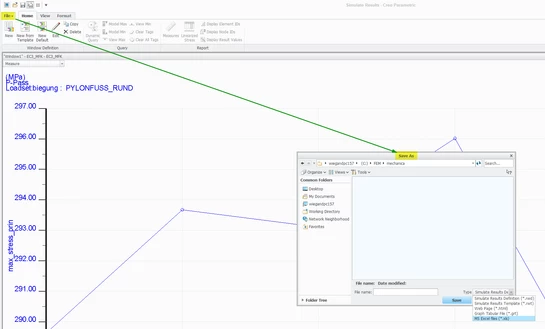

I found this topic due a point that you described - I also could not export the result as excel file (as I am doing since I started with this PTC product) - but had no problem to export it as .grt.
Copying the values from .grt to excel cause some formatting problems (it is not recognized as a number) what is easy to solve but causes unnecessary more steps.
As I wrote, I am using "save as excel" for the graphs at long time but now there is nothing stored in the working directory -and I am using Creo 10.0.4.0
This is not normal - we should be able to generate - and store - .xlsx files in the working directory, but it is not happing.
First I thought that was a configuration problem with my Creo - but now I see other people describing the same issue!
