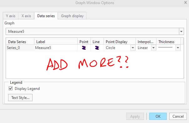

I ran an optimization study in Creo Simulate.  I have several measures that I would like to export to use externally.  Currently, the only method I can find to get the data is to make a graph then "Save a backup" of the graph to Excel.
Is there a more efficient way to do this?   I would also be satisfied if any one can tell me if there is a trick to get more than one set of data on one graph.  The UI looks like it should be possible, but I can't figure it out.

If you have a lot of measures you can always write yourself a script that opens up the report file and copies your specified data into whichever File you like. But I guess this makes only sense for a big amount of data. I don't know about any better way.
N.Barnes15-MoonstoneAuthor
That could work.  Can you please point me in the direction of where to find that report file?  Perhaps a likely directory or file extension.   I poked around in the output files for raw data before and I was unsuccessful. Thanks.
In your working directory you will find a folder for each different analysis you specified. In this folder are many files. One of them is a file with the ".rpt" extension. Open with Note Pad and you will find your measurement values somewhere near the bottom.
