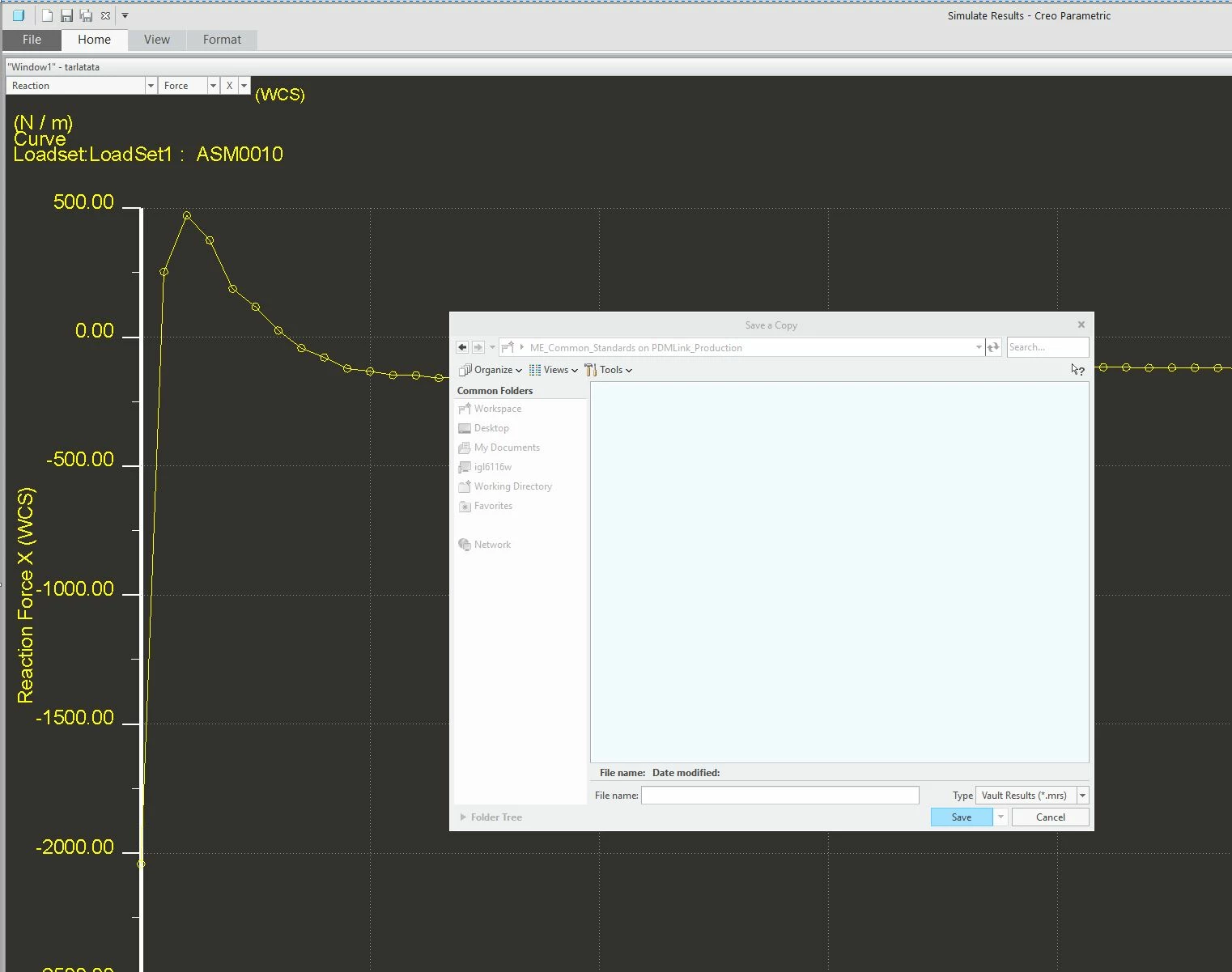

It looks so simple according to the documentation. Select your graph windows, save a copy, choose .xls in drop-down menu.... But the only options I can see in the drop-down menu are .mrs or .mrp

This is probably a windchill / PDM system conflict.  Are you using windchill / intralink? Can you try outside of that?

No, I do not use windchill/intralink. Thanks for your answer anyway

Hmmmm.  I looked a little closer to your image.  It is looking in PDMLink, which is windchill.IS LOOKING IN PDM SYSTEMIS LOOKING IN PDM SYSTEM

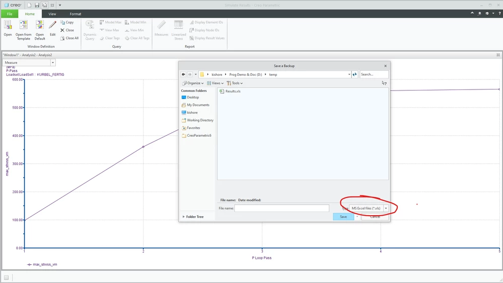

Goto File -> Save As, you would see the option to export results to xls format.Annotation 2019-10-18 171118.png
