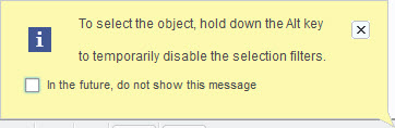

fail to select objects
I fail to select the objects in creo parametric 2.0 almost half of the time and a warning message will pop out saying that"to select the object, hold down Alt key to temporarily disable the selection filters"
Just like this one.
I don't know what does this mean and what I should do.
Can anybody help me fix this problem?

to prevent displaying the message, please activate tab related to object you want to select. This method has to be used especially in Drawing mode. For example: If you want to select sketched 2D geometry, then you have to activate Sketch tab.

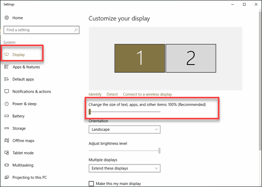

I know this is kind of an old thread, but we just ran into this same issue where I work and for us, it turns out to be caused by a changed feature of Windows 10 to "scale" certain display items.
Open the Settings of the display by right clicking on the Desktop and choosing "Display Settings"
On the Display settings page, there is a slider labeled "Change the size of text, apps, and other items:"
When not set to 100%, we see this exact issue you are reporting.  It must be due to the setting not mapping the new percentage properly to mouse clicks, pre-highlighting works fine, but selection is hit and miss.capture.gif
