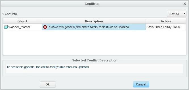

Hello everyone,
I have an interesting / terrible issue we stumbled across today. It seems that something has changed in how Windchill or maybe CREO handles family tables.
We have recently (May) upgraded from WC9.0 & WF4 to WC10.0 & CREO 1.0. We have many family table common components like washers, screws, etc.
Today - I had a designer adding a washer to the family table and he complained that he couldn't do it with out checking out the WHOLE family table. This is an issue because some of the washers are released for production which means that they would have to be revised for no reason before they could be checked out. I figured that he was doing something wrong but, it turned out actually he was following our documented procedure. There is a "new" window that pops up now when you are adding an instance to the generic.
[cid:image002.jpg@01CD6BFF.B87106E0]
I did a sanity check and we are not able to even update a current instance without checking out the whole family table either.
Does anybody know if this is new intended functionality?
If so is it driven from WC or CREO?
And how can we go back to SN(not)AFU, config setting maybe? (I could not find one)
Any help would be much appreciated...

I think PTC is just now enforcing what they have been saying all along.
The whole should always be checked out and back in to be sure that all the instances are in sync with the generic.
If you don't do it then you get instance 345.C loading generic 12345.F when 12345.H is the latest generic.
Now when you go to add 789.A instance, it isn't in the family table because you don't have the latest generic loaded.
It is a 2-way relationship that MUST be maintained at all levels across all instances.

I think this type of problem is an issue in most (if not all) PDM
systems out there.
I would argue that the instances should act as standalone parts with
respect to dimension changes, but adding a feature to an instance also
adds a feature to the generic and should cause a mass update of the
generic and all of the family table parts (bummer).
I wonder how this is different than Interchange groups. Adding an
instance to an interchange group should cause an update of the
interchange group, but should not cause an update of all of the members
of the group. Adding a feature to a member of an interchange group
should not cause a mass-update of the group. Changing the interchange
group properties should not cause a mass update of all of the members of
the group.
