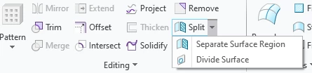

Hello @BP_10313542
I checked your issue, and it does not exist in Creo 10, the surface regions are stable when switching between instances. I did not test earlier versions than Creo 10.
Creo 9 introduced the ability to divide and split surfaces as a core feature. This option also enables you to incorporate the divided surface into a family table.
My recommendation to you is to upgrade to the newer Creo version.
