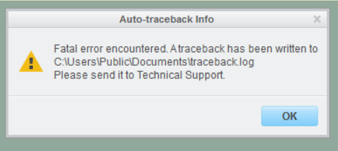

I have problem with my Creo Parametric 3.0 - student version. When I run program I always get this window and Creo don't started.
Any ssuggestion or advice? Please.

Is it happening just after launching Creo or when performing some action?
Not sure it is due to graphics or not. However making a test by adding config graphics as win32_gdi in config file may help.

It happening just after launching Creo.
What exactly should I do?

List your computer specs with graphics card information?
Desktop or laptop?
ladanic1-VisitorAuthor
October 30, 2015
I have a laptop, Asus G550 running on Windows 8.1 pro, i7-4710HQ CPU, 16 gb RAM and graphical card is: Nvidia Geforce GTX 850M.
October 30, 2015
I have the same problem with installing any version of Catia and Abaqus. I know this is forum for PTC Creo, but I think it goes for the same problem...
