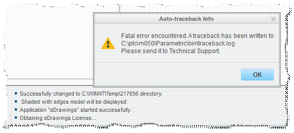

Hello Everyone,
I’m attempting to setup a new server machine with an installation of Creo 3.0 M050 (64bit) and eDrawings 2014 publisher Version 10.4.0.101 (64bit).  The server machine runs on Windows Server 2012 R2 (VMware Virtual Platform, x64-based PC).
Everything seems to install fine, but when I attempted to publish any and all models (large or small) it will give a “Fatal error encountered” message and crash Creo.  I’ve attached the traceback log file.
This same software combination was installed on a different machine and things work fine (Windows 7 Professional, VMware Virtual Platform, x64-based PC).  The issue seems to be machine specific.
NOTE:  I used the “License Configuration Tool” to point the Floating License Server field to our license server (we own 1 network license).
I opened a call with eDrawings support, but was told that the issue was not reproducible and suggested that I use it on a machine that works.  Nice!
Has anyone else experienced this error?  Any suggestions for me to try out?  I’d really like it to run on this Windows Server 2012 R2 machine.

I had a GoToMeeting with eDrawings support (Geometric Global) this morning and found out the following:
·        They saw the issue first hand then added some eDrawings diagnostic environment variables for logging and determined that the problem is most likely Windows Server 2012 R2
·         It was stated that they’ve had many customer calls on eDrawings crashing Creo on Windows Server 20012 R2
·         There is Internal licensing agreement battle with Solidworks on releasing the latest installer files that they need to create the next version or service pack.  This means no time table for an available fix.
·         The problems lies with Windows 8 and above.  Recommendation was install on a Windows 7 machine for the time being
