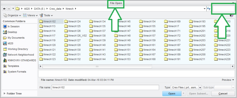

Hello all,
is it possible to set search function to search thrue all subdirectoriers? (Creo 2.0 M200)
Don´t need permanent settings --> something like "now search thrue all" ,when l realy need it...
We don´t use Windchill and any other PDM
Thanks for any help
Milan Bonka

Chris3
Feb 23, 2017 1:12 PM UTC
You need to setup a search path:
Creo Parametric Help Center About Searching For and Retrieving Models
Creo Parametric Help Center To Edit a search.pro File
Creo Parametric Help Center Example: Adding Search Paths
mbonka2-ExplorerAuthor
2-Explorer
Feb 23, 2017 1:21 PM UTC
Hello CHRISTOPHER REES
thanks for tips, but that´s not what l´m looking for.
Feb 23, 2017 1:13 PM UTC
What is it that you are trying to do?
Are you trying to create a mapkey or something along those lines or are you just trying to locate a file?
2-Explorer
Feb 23, 2017 1:19 PM UTC
Just trying to locate a file.
I would just use windows explorer for that.
Would that work for your situation?
11-Garnet
Sep 19, 2024 1:32 PM UTC
I have the same question on Creo 7.0.8.0
Why can't this search box search through the folders like other CAD packages? How to make it search through it all? Any updates now that we are in 2024?
