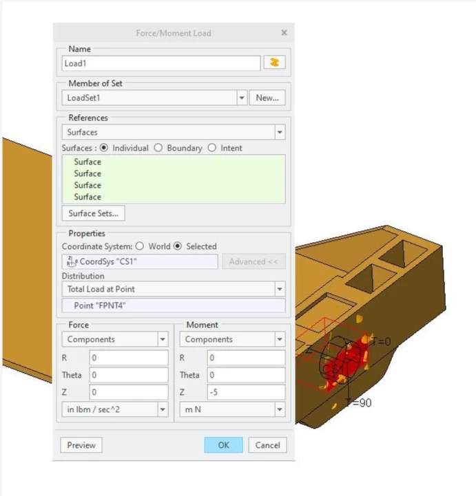

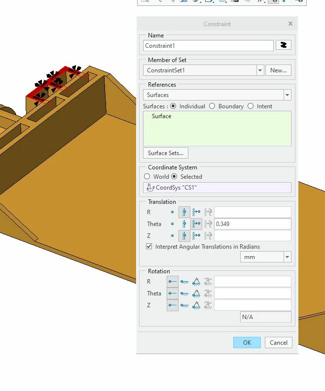

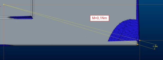

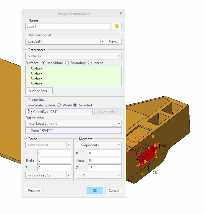

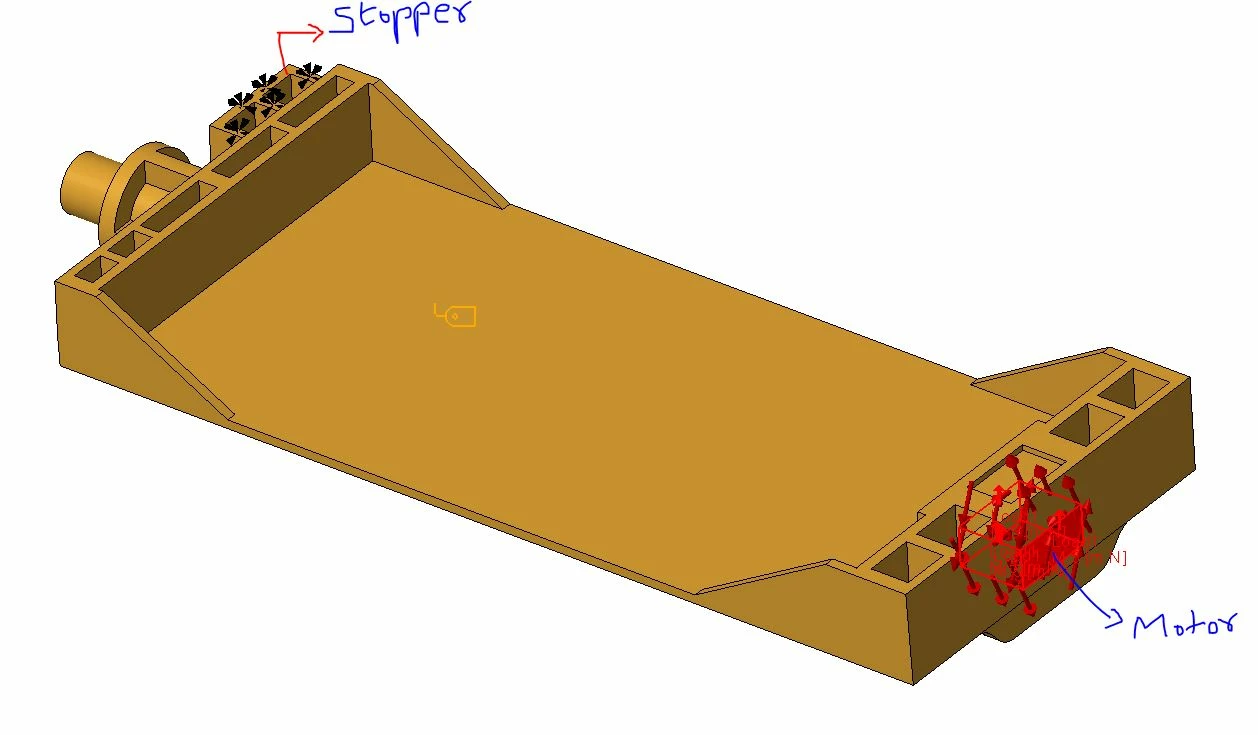

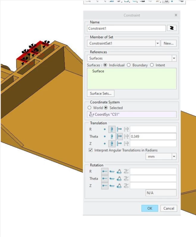

We need to find the stress when the part is twisted at an angle. It's shown in the capture-1 below that a motor powers the pocket at one end, while the other end has a stopper. load (capture 2) & constrains (capture 3), kindly advise me on how to calculate the stress values at various angles?
Plastic is the material that is used & currently I am using Creo 7

Do you know you can perform mechanism analysis and get reaction forces at defined point location then transfer the force measured to simulation for accurate results.
