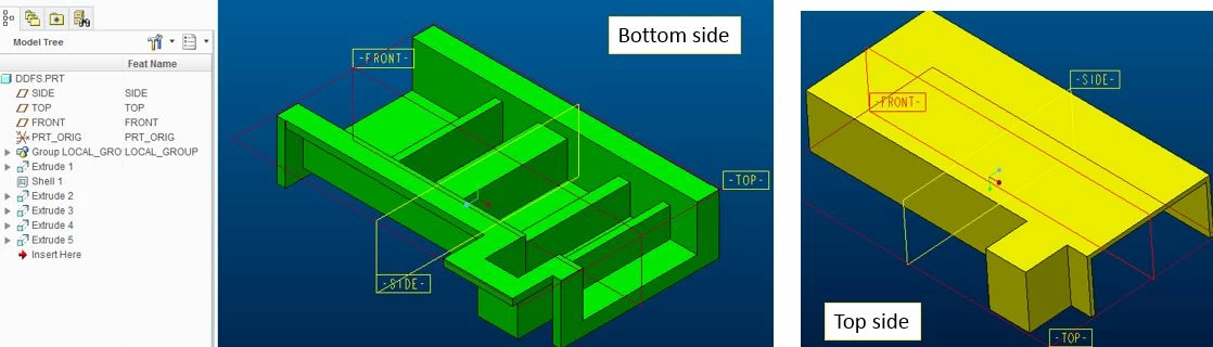

I want to flip my entire model (mirror) with respect to top plane in Creo 2.0. I am facing issue regarding feature failure (depended features are failing) if I am flipping first feature.
Is there any possibilities that I can flip my entire model with respect to plane and co-ordinates?

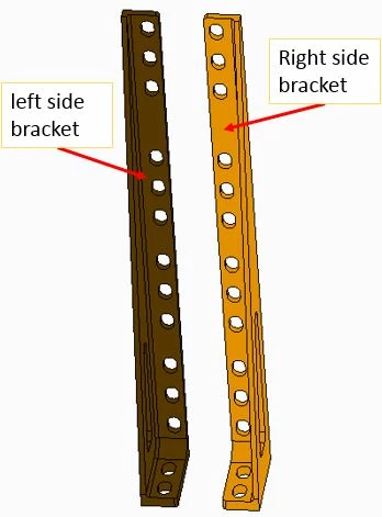

I have attached snapshots simple example of actual model and required model for better understanding. This is very simple example and I have to do this for very complex models.
So any help will be great.
Thanks in advance.
