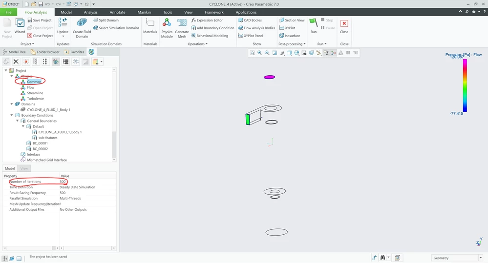

Flow analysis running past iteration limit?
Does anyone know why a simulation would run past the iteration limit? I had a run going yesterday set to the default 500 limit, and I didn't realize it ran right past it. I manually stopped it at the 516th iteration. I double checked and the limit was set correctly, so what could have caused that? Thanks!

I have stopped a run and then restarted. After the restart, the analysis ran for the full number of iterations again. So I had total iterations of 500 plus however many iterations had been done when I stopped the run and restarted it.

Hi
Assume you meant creo flow. You can change it under common module of the physics. It is in the simulation tree. Every time you click continue run, it counts from 0 again. It is a limit for each run not global iteration numbers. thx.
