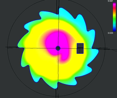

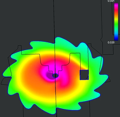

Hi there,
I've been having a bit weird issue. I'm using Section Views in postprocessing, and it keeps messing with the color representation of selected values (as seen on images below). When I tilt the surface to some extent, the colors are OK, but as I'm moving it back to perpendicular view, the colors change as if there was weird light reflection going on (which probably is). I have tried to turn off the lights in Scene Editor, but it did literally nothing for the Flow Anaylsis modue, as if it had some lightning on it's own.
Any suggestion what might be wrong?

Creo flow analysis lighting settings are not coupled with the creo parametric rendering settings. I believe what you see is due to this direction is the lighting direction which lead to spot light reflection at this angle. I believe we fix this in creo 9, but could you create a ticket for this issue and we can take over and study it. Thanks.

Oh, I kinda guessed that might be the issue, so thanks for the confirmation. I'll be looking forward to getting hold of creo 9.
