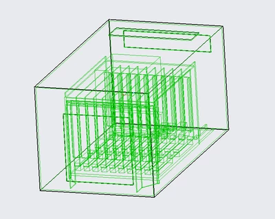

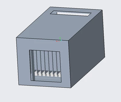

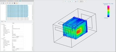

I am modeling an electronics chassis with circuit cards in it.  The material properties of the PCBs are defined in the model and they are showing as solid components in the  simulation domains list.  The fluid domain appears to appropriately have "negative space" where the PCBs are.

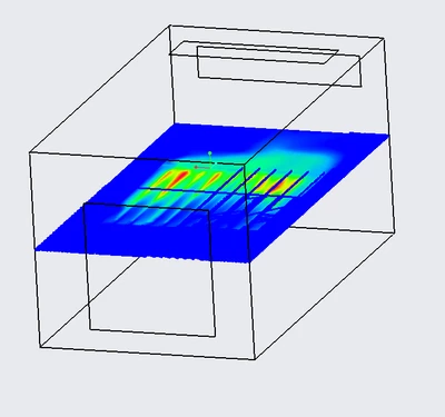

However, when I run the model and I try to investigate the surface temperatures of the PCBs by selecting them in "boundary conditions", selecting "yes" for surfaces and "Temperature" for a variable, nothing shows up.  When I do a cut plane through the chassis, the heat dissipation from the PCBs is obviously changing the air temperature, but I can't see the PCBs themselves

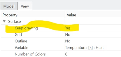

Yeah, that's right. You can keep the display on by setting "Keep drawing" to Yes on the View tab of those interfaces. If it gets in the way just set it back to No.

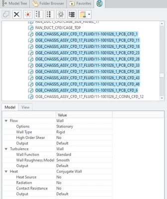

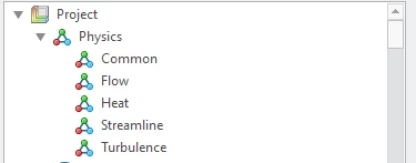

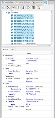

Could you show the physics that you have selected. And then a few more questions.
What are the properties for the PCB"s? Density, specific heat and thermal conductivity
How is the heat source set up?
How are the interfaces between the PCB's and the air defined?
Sep 21, 2022 8:03 PM UTC
Thanks for the quick reply!  Here are the physics
here are the density, cond, spec heat, and load properties for each PCB
here are the interfaces between the fluid (air) and the pcbs

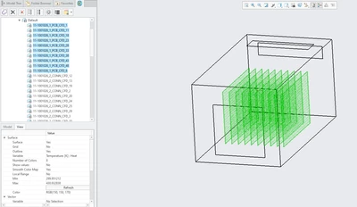

OK, since I highlighted the fluid - pcb interface, I see how that went active in the display.  I was able to select view surface and temperature in the interface section and now I can seethe temperatures of the PCBs.  For some reason I thought to see the temperatures of other components I needed to look under boundary conditions!  Is that basically the answer - select the interface and view that temperature?
