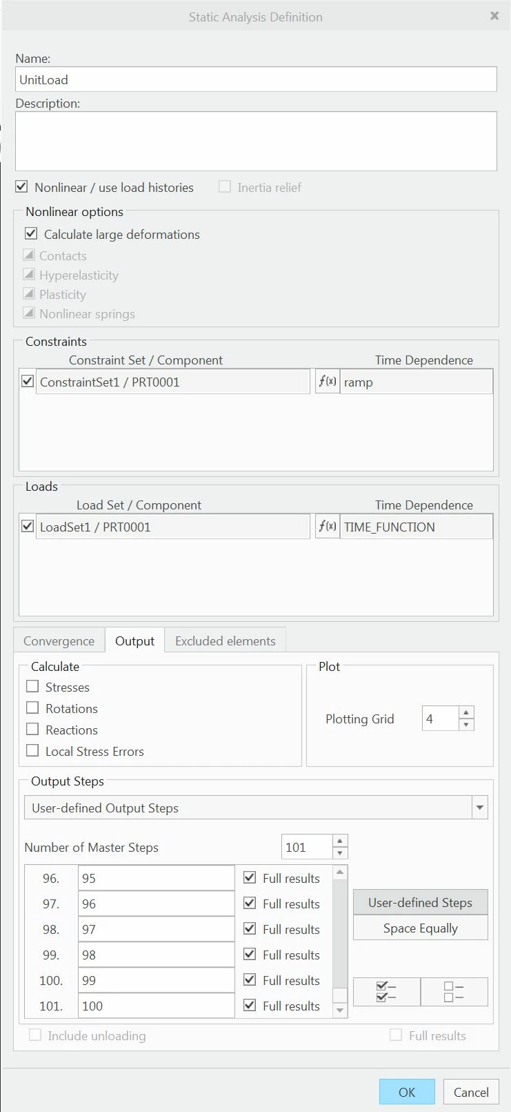

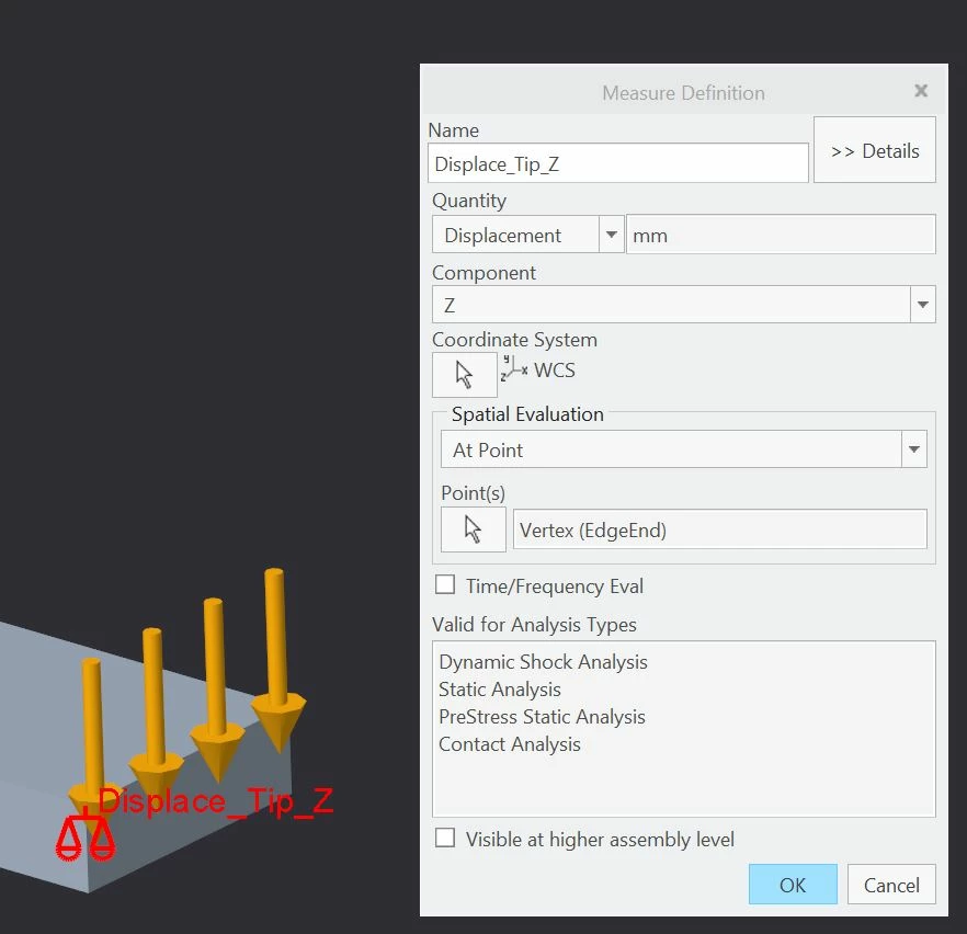

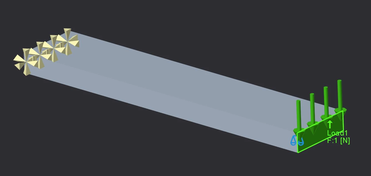

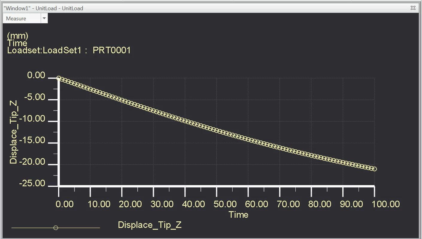

See attached Images.
In summary:
Use non-linear /  load Histories
Apply unit Load
In the analysis definition - Load Time dependence...
   Define a FUNCTION vs time for the load value
In the Analysis definition - Output
  make sure the final master step = final time in your time dependence.
  make sure you have enough master steps and spacing to make a good chart.
Define a measure for the displacement. (do not select time dependence)
When plotting results you may need to export to excel and scale the TIME by the appropriate weight from your FUNCTION to obtain the applied load.  In my example the time = the load applied because I apply 1N * 100 at final time of 100. and evenly ramp from zero load. (my FUNCTION has slope = 1)
In summary:
Apply unit Load
If this does not answer your question please upload your image using either "Choose Files" or the CAMERA icon in the formatting bar.

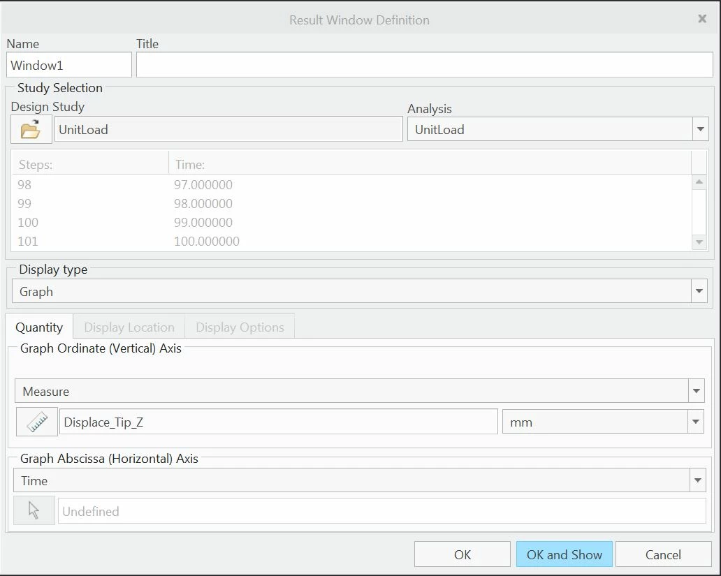

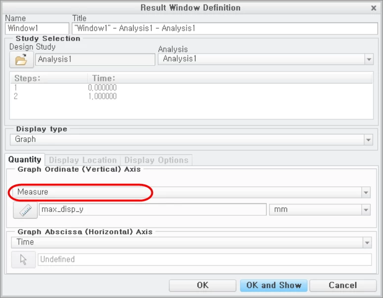

Hi sweetpeahub,
Thank you so much for very helpful reply.
The key point of your lesson to me was using the 'measure'.
I learned that when the 'measure' selected for the vertical axis, I could choose the 'time' for the horizontal axis.(attached image)
Now, I have another question. Can I let the horizontal axis show the 'Force', not the time?
I thought I can use the measure for the x-axis, and because there is not the Force in the predefined measure list, I tried to define a measure that present the force, but it is not simple...

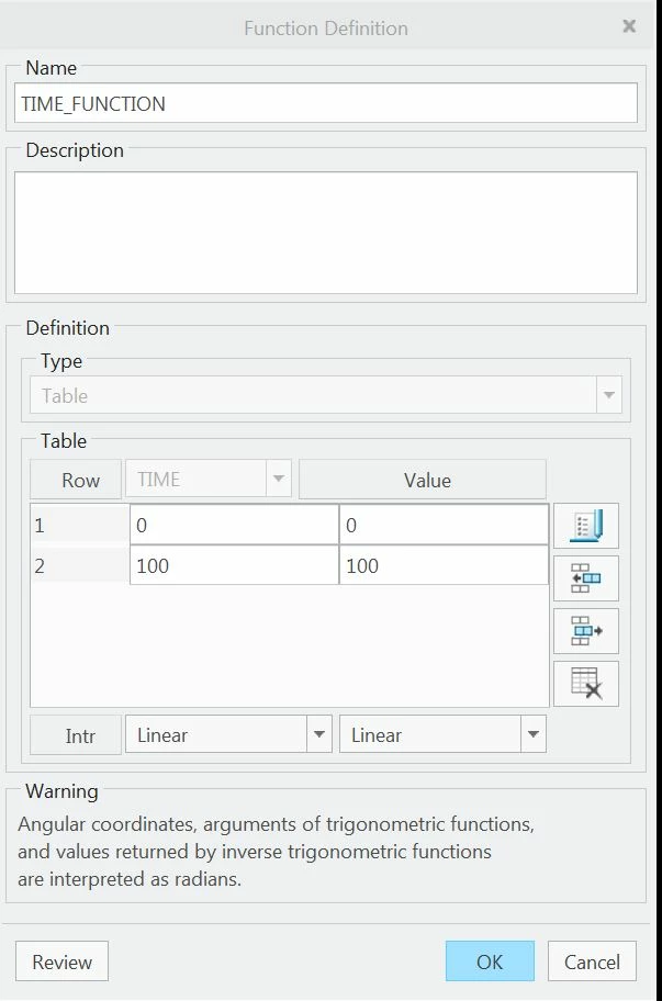

This equation for load as function of time:
AppliedLoad(time) = LoadMagnitude * TimeFunction(time)
This has loadmagnitude = 1
Load Magnitude
This has TIME_FUNCTION(time)
TimeFunction

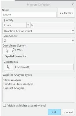

3 ways. Way 1 and 2 discussed in previous post.  I will re-state.
1.   Have 1:1 slope for time vs load applied.  Just the label is incorrect.  Change the label.

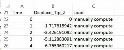

2.   Save-as the graph "deflection vs time" to Excel .xls (or .grt which is text file) and use spreadsheet (Like Excel) to convert time to load.  Compute or enter the load manually in spreadsheet.  XY chart in spreadsheet.

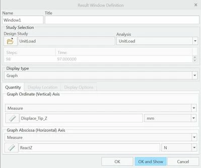

3.  In some cases the input force applied is found by the reaction force in the same direction at the constraint.  Since load vector = -1Z then Reaction Z.  This is a simple FEA.  Verify results are correct for other FEA problems.
