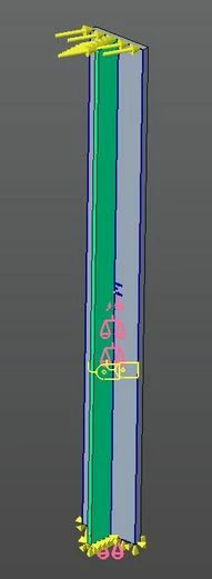

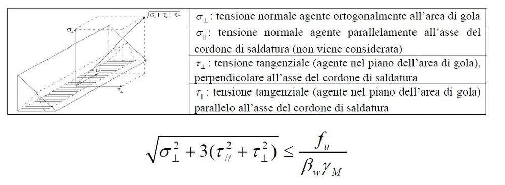

I want to try to extrapolate force (tension) from a welded structure to perform a calculus as prescribed by EN1993-1-8.
I want obtained the forces by measures of a simple truss loaded by transversally.
On each side of the green beam I want to simulate the presence of two filled weld with a=5mm.
I used two kind of measure: Force and Interface.
Looking on the Help it seems the proper one should be the force measure, but, in this case, I think both should be right.
Exept that the results are different, so which are the right?
Bye

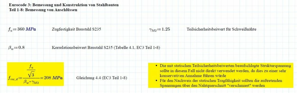

I think EC3-1-8 is not possible for FEA
my info (in german):
gfraulini17-PeridotAuthor
September 5, 2019
Thanks, after I'll try to translate from german.

your example is in creo 5...
