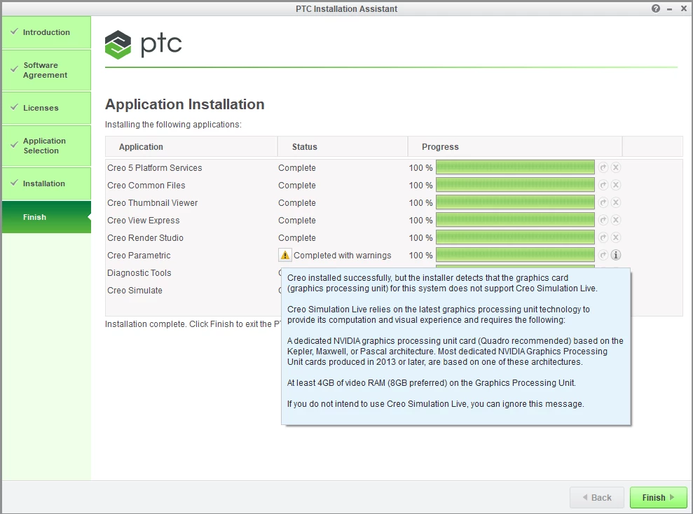

During the installation of Creo 5.0.3.0
May laptop card is a GeForce GTX 860M (nvidia specifications)

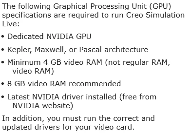

PTC requires:
Why does my card is not supported?
It is based on Maxwell architecture, has 4GB Ram and the latest drivers.

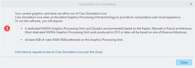

PS: During execution on a simulation, Ia also get this error:
PS2: I was wrong about the 4GB. It is 2GB Ram Video Card. It this that is blocking the execution of a simulation?

jgoncalves,
We have some cases where a 2GB card does work within Creo Simulation Live.  I recommend upgrading to the latest Nvidia graphics driver for your machine and try running CSL again.   You have a Cuda enabled card, so hopefully it is just an out of date driver and then things will work for you.

jgoncalves,
Todd Kraft
January 10, 2019
Thank you ToddKraft.
I was relying on the Nvidia GeForce Experience to update my graphic card.
I ran Device Manager (Windows 10) and got a newer driver.
It is working now.
November 6, 2019
Yes, 2GB would prevent the solution working correctly.
