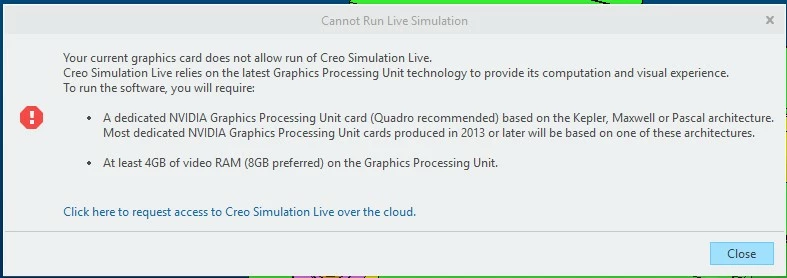

I have the graphics card of Nvidia Quadro P4000, with 8GB RAM. But while running Creo Simulation Live, I am getting the following error.   Can anyone please confirm my graphics card will be supporting CSL or not.

update graphic drivers and check again using PTCHardwareCheck.exe utility
ftp://ftp.ptc.com/outgoing/Creo_Simulation_Live_Beta_Event/PTC_HW_CHECKER.zip
