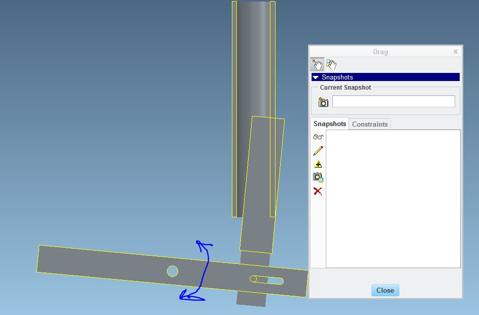

I need help with Drag Components.
The objective is to obtain vertical motion by a slot in an oscillating lever arm.

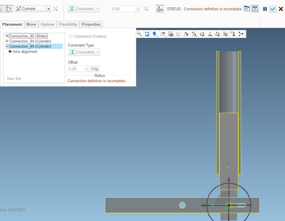

I have constrained the lever arm using pin constraints and the vertical rod using the slot constraint, however, when constraining the rod to the guide the mechanism locks.
I have tried the other constraints and have not found any that work. Please help me on this issue.
July 10, 2014
You might have a circular reference going for constraining the piston.
