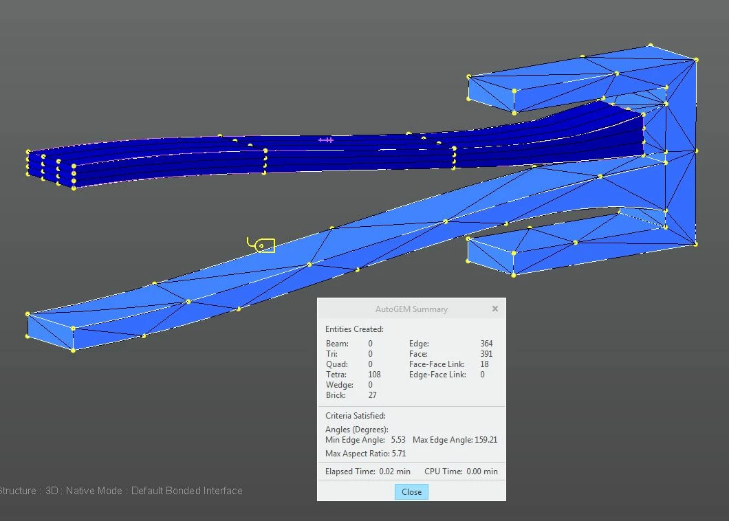

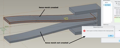

I tried to create mapped hexamesh for a full symmetric geometry. The first side was OK, but the second side is not. Error nitice can be seen at picture:
The two mesh region is total same. What is the reason of this errror?

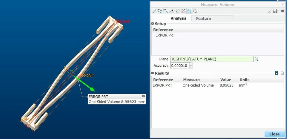

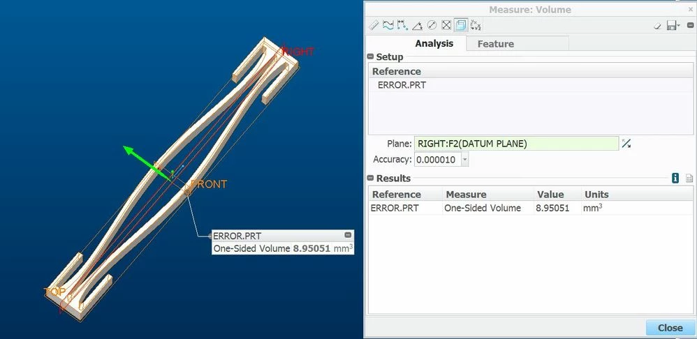

I made the volume region attached to the geometry and not to the plane.
Bye
skunks
May 9, 2019
please check the sketch 1
rrakos1-VisitorAuthor
May 9, 2019
The sketch 1 is a simple and closed contour. What should I check on it?
