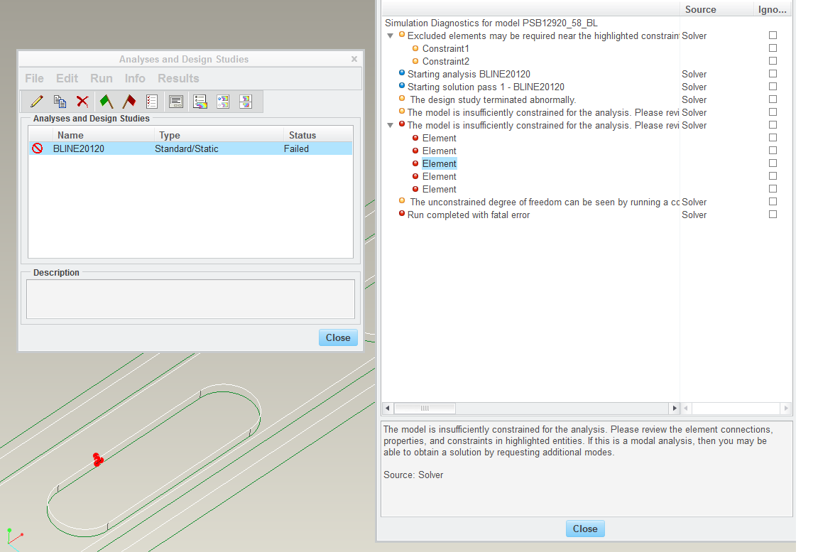

Hi All,
    April 3, 2017
    Check the following circumstances for simulation diagnostics:
    • Examine Material Properties assigned to part, components or fasteners
    • Check Constraints
    • Identify connections between components or different types of meshes
    • For Load/Constraints definition select mesh points, not geometry vertices (select with RMB > Pick From List)
    • Examine Spring Element Properties
    • Examine Beam Element Properties
    • Identify if slippage can occur where Contact Regions are defined
