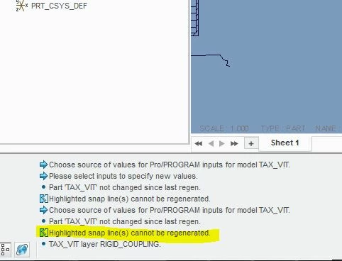

I keep getting the warning message "highlighted snap lines can not be
regenerated" in drawing mode for some of our template models. However, no
matter what I do, I cannot see any snap lines, highlighted or not. Is there
some way I can get these snap lines to be visible so I can figure out why
they can't be regenerated?
currently im working on creo 3.0 mo90.

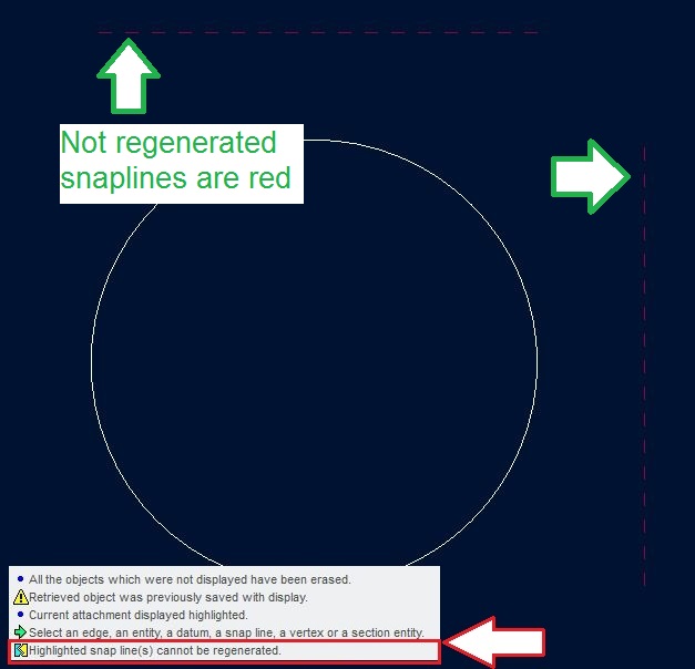

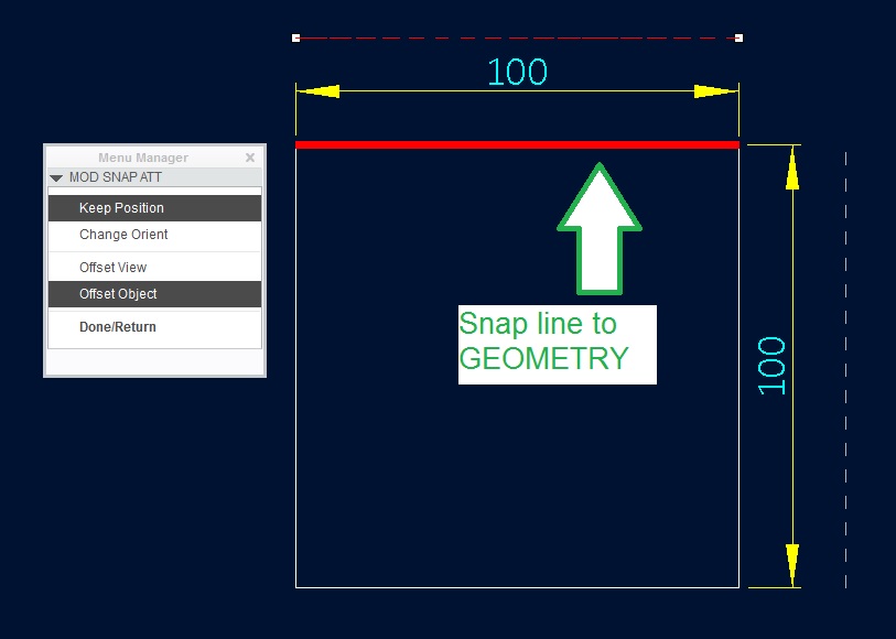

Hello SARAVANAN K
in my opinion snap lines where created in related to geaometry that is no more present in your model/drawing.
See following pictures:
1. Snapline created to Object/geometry
2. Square geometry was replaced with circle
From my praxis: Snaplines related to VIEW are much more consident that snaplines related to geometry.
Hope it can helps
Regards
Milan Bonka
