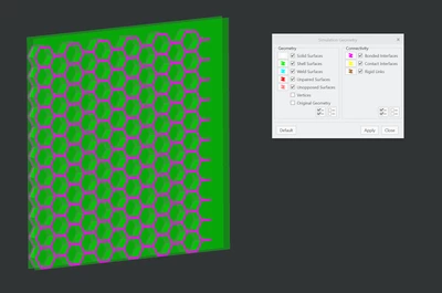

Asking for advice on how to analyse an aluminum honeycomb panel. The layup is 0.5mm aluminium sheet, 20mm aluminium honeycomb structure and a final aluminium sheet. These make up a plate of 400x400mm. How should I set this up for best analysis in Creo Simulate? I'm thinking the Shell feature would be the right way and make a laminate material. Should one then have the honeycomb as a material type, to be defined, or should one define a Laminate Stiffness and use that shell as the middle layer?
Alternatively define the honeycomb material as an Orthotropic material and apply that to a geometric part representing the honeycomb core?
Furthermore, any hints or suggestions to such properties, as I have not yet dealt with honeycomb structural properties?

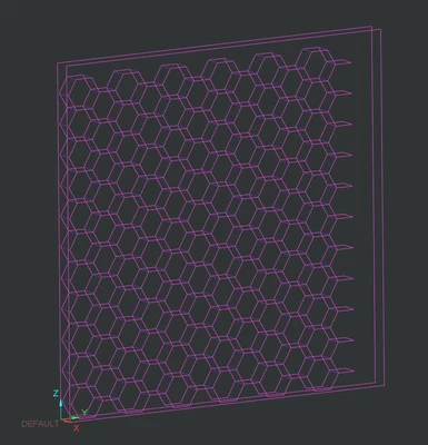

I would model the honeycomb as non-solid quilt then assign shell properties.
You can make use of patterns to assemble the honeycomb. In hindsight, I would probably make it larger than needed then cut down to 400mmx400mm to assist in making the pattern work.
In order to get the honeycomb to attach you need to set the default interface to BONDED.
The magenta lines (2nd image) will tell you it has joined. (Review Geometry command)
For screwing I would probably make circular  "surface regions" at each screw location and then join with rigids. You could also add some cylindrical non-solid surfaces to use for screw attachment.
In summary, I would not try to use Creo laminate layup properties, but rather build the structure as shown with simple shell properties.
Keep in mind when doing the honeycomb pattern that walls are shared and you do not want two of the same wall coincident to each other.
in other words, the pattern will contain partial hexagons.
