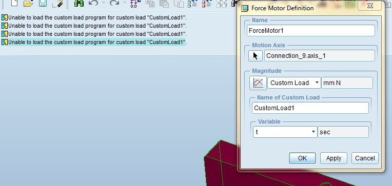

Hi all,
Boris could you give us more informations regard how custom loads works?
In my case I don't understand how could I link the load with the external application because ProE doesen't ask me nothing (application, folders,...) and returs me «Unable to load the custom load program for custom load "CustomLoad1"» in the Message log.
PS: I use WF5.
How we can link the Mechanism environment with an external application to make a feedback circuit?
I think, for example, with Mathcad 15?
In AMEsim you can build a feedback circuit and, with the latest versions, you can link the analysis with the CAD.
7-Bedrock
December 13, 2016
Giulio,
there is a config.pro option "mdo_cl_executable" which you should use to specify the path to the Custom Load executable. So it should look like:
mdo_cl_executable your_path_to_the_DLL_directory\CustomLoad.dll
Boris
December 13, 2016
Sorry but also reading the PTC Help section I don't understand: I need always the toolkit?
How can I link Pro/Mechanism with an external software to let them communicate together?
It is possible having some example?
