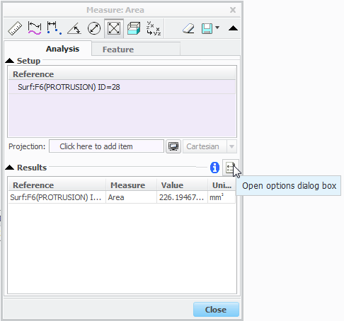

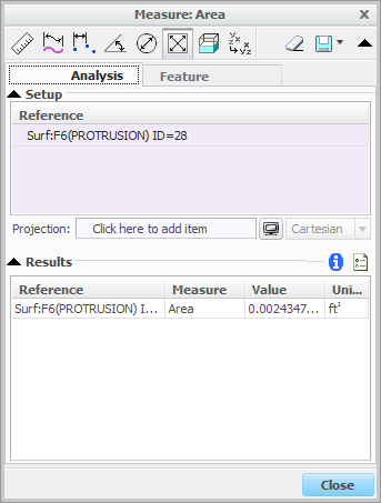

You can also simply change the measurement units, instead of changing the model units.  (At least, in Creo 2 you can.)
Open the options dialog:
Change the units:
Voilà!

August 11, 2016
Nothing I like better than an icon that can't possibly represent what a single word would do; but then it makes internationalization easy by not having to do so, except for the tool-tip. Oh, wait ...
