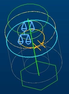

December 13, 2017
not creo parametric, but
